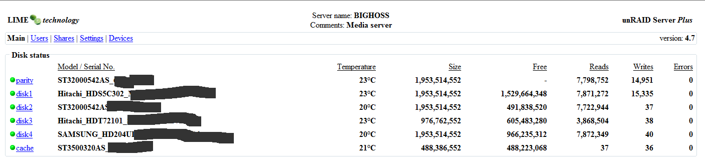

July 22, 201115 yr Author As I'm moving stuff I am looking is two spots. In the unRAID web admin, I can see writes are being done to the share drive and not the cache drive. I also am logged in the console and go into the share drive itself and can see that nothing is there. I've read the wiki and I have each share set to use the cache drive. Wasn't sure if I was missing something.

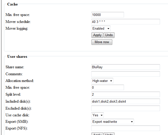

July 23, 201115 yr Author Anyone have any ideas why the cache drive is not functioning correctly? Attached are two screenshots. One is how I have the share set up to use the cache and the other is a shot of what it looks like when I am transferring to the "BluRay" share. You can see that it shows that it's writing directly to the share and not the cache drive.

July 25, 201115 yr Author The problem was I did not have a "minimum" value set on the shares. They were all set at zero. Set each of the shares at a minimum of 20 GIG (20000000) and restarted array. Cache drive working correctly.

July 26, 201115 yr FYI, the minimum free space not being set won't mean the cache drive is not used. However, without it set you could get a no free space error due to the cache drive being full. Something else was the real issue but apparently it's cleared up now. It could easily have been due to that issue in your syslog. Peter
