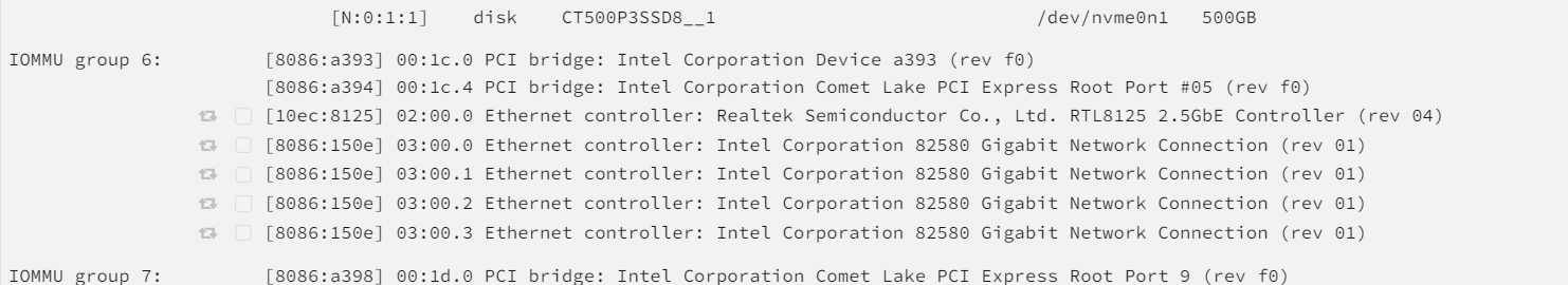

I'm trying to isolate my network interfaces to use on VMs in unraid.
I have a total a 5 ports.
  • 1x onboard NIC - 2.5GB (RLT8125)
  • 1x quad port PCIe network card  - gigabit Intel 82580
The onbloard NIC is connected to LAN to accès unraid via the webGUI.
I'm trying to isolate 2 of the 4 ports on the intel PCIe card (I'm willing to compromise isolating the 4 of them)
As per my research, I'm trying to bind those to VFIO at boot using the Tools > System devices option in unraid.
However, all of them are actually marked as "In Use By Unraid" (see screenshot below), even with VMs and Docker disabled.
My question is :
Are they all "in use by unraid" because they're in the same IOMMU group as the 2.5Gb NIC that I use to access Unraid via webGUI ?
If so, what is the solution to seperate them and bind them to VFIO at boot ?
If that's not the reason ? Why are my Nics marked as "in use by unraid" and How can I set unraid to "unuse" them.

Yes - to be able to use VFIO you have to be able to pass all devices in the group.  To achieve what you wat you are going to have to be able to get them into a different group.  Quite what the solution is with your motherboard I do not know - maybe trying a different PCIe slot might work?
