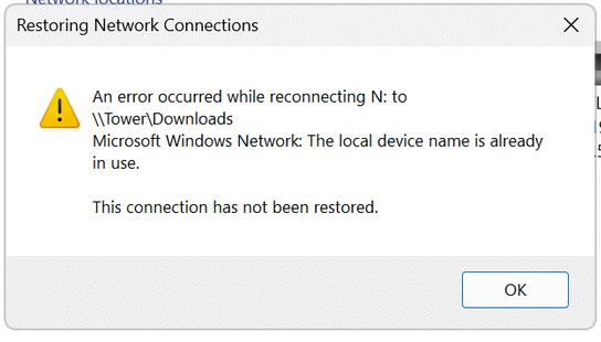

I have followed the Unraid & Windows 10 SMB Setup.pdf you recommended, but I still cannot access this Unraid server via SMB. I have followed the guide to a tee, but still get the failures shown in the accompanying attachments. I can access it by web browser, but I need SMB access for my Windows 11 media player. No problem accessing the other Windows (10 and 11) and Unraid computers by web browser or Windows File Explorer. I have also included another diagnostics file.985882924_Mappeddrivefaildifferentcredentials.png.d1e80c0a935b9bfa33fa14dbb5af06ea.png

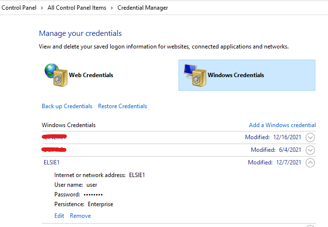

First get a Screen shot of the The Credential Manager for both of both of these (Hopefully, you have only one)  as shown below:

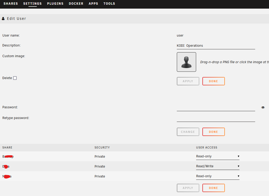

From the TOWER GUI  go to   Setting  >>>  Users    Under   "Share Access"   click on the 'user' named in Windows Credential Manager and take a screen shot of that.  It should look like this:
Post them both up as I have done.
