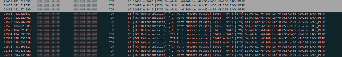

I've a weird behavior and I need your help. I'm running few VMs and Dockers but I can't access my dockers from my Win11's VM
Let me explain a bit my setup:
VM Windows 11 on LAN Network
VM OPNsense (gateway LAN & Server Network)
My Unraid Server (Server Network)
My docker (Server Network)
From my Windows 11 VM, I can access my Unraid Server, and I can access my OPNsense VM. But if I tried to reach a docker, it fails. I've no packets received on my firewall.
I tried do to a capture on my Win11 and here is the result:
Any idea why ?
Thank you :)
