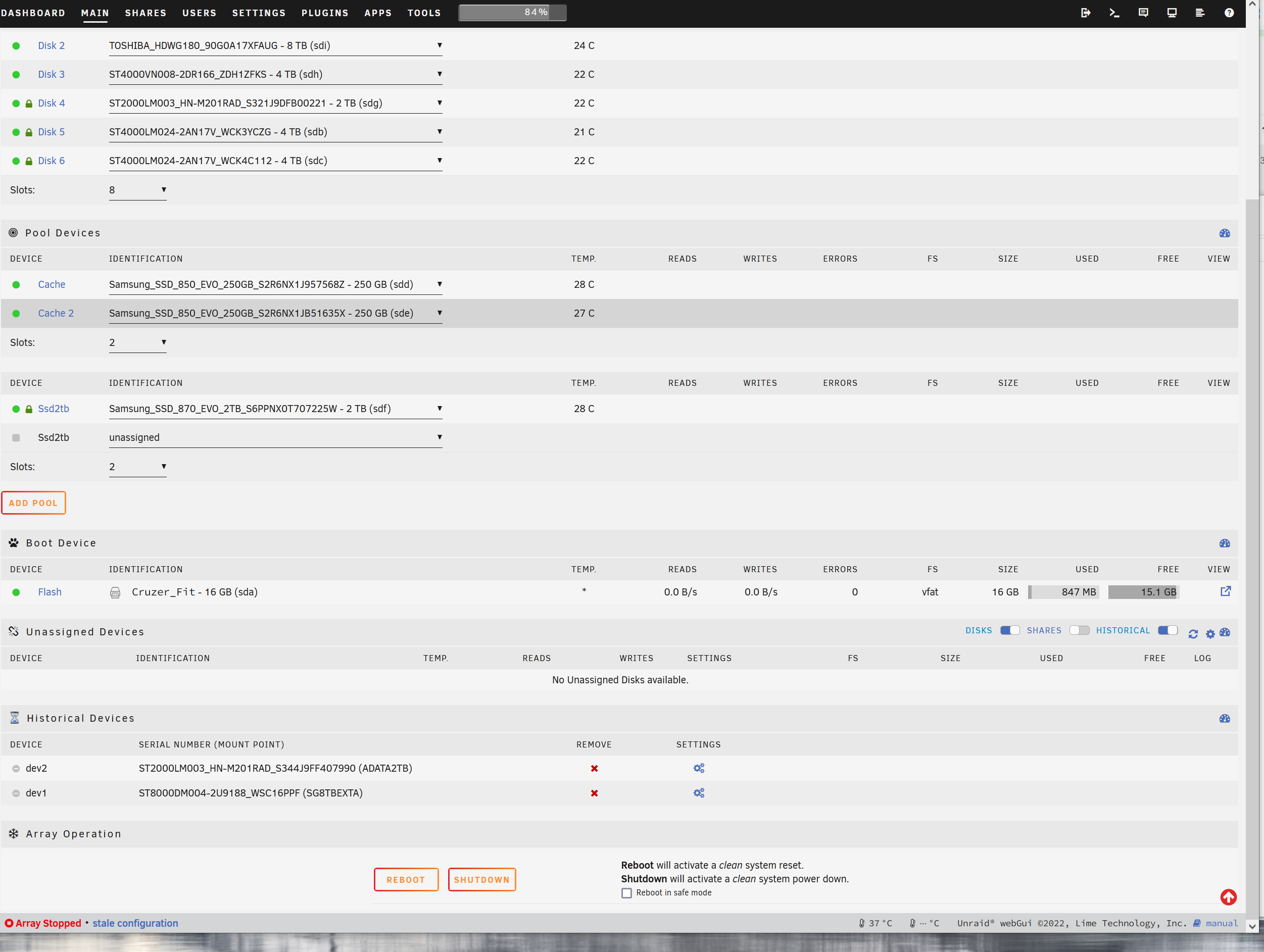

After entering my encryption key to start the array, Firefox said that it will have to resend the info to show the page, I hit ok, but now all the disk slots are selectable, but there's no option to start/stop the array, only shutdown (see attached)
Diagnostics attached.
percy-diagnostics-20230206-1347.zip
That's a known Firefox problem, reboot and use a different browser (or don't hit resend).
