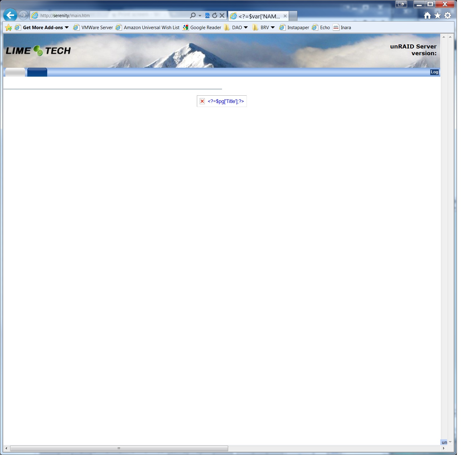

I'm currently on unRaid 4.7. It's been working fine, but since I recently made a backup of all of my data, I figured I'd try the Beta 10.
I followed the instructions. Copied the bzroot and bzimage file over, deleted the config/passwd and config/smbpasswd files. I didn't have a config/shadow file to delete.
How long should it take to come up? With 4.7 it takes a minute or two (not long at all). I waited for 5.0Beta10 to come up and on the webpage, it looks like part of the new unRaid screen, but nothing is visible. It is like it is missing the graphics/images, etc.
I'm on Win7 64bit and IE9. I've tried Safari on the Mac, Firefox on both PC and Mac and it doesn't ever seem to come up. This is after waiting upwards of 30 minutes. I've copied the files over again, etc. Same thing.
I put the old config files and 4.7 system files and it comes up immediately for me. Am I missing something really basic in the upgrade instructions?
This is on Lime Tech's MD-1510 server.
Sounds like you have "php" loaded as an add-on.
Aye, I don't recall why I installed it :). Any idea if  unmenu, airvideo, apcupsd or powerdown require it? Those are probably the only packages I can't live without at this point. If it does, I'll just sit on the sidelines and wait :).
You can fix it in about 30 seconds.
See here:
http://lime-technology.com/forum/index.php?topic=10840.msg103297#msg103297
however, none of the packages you mentioned use "php"
I put it in the go script and still no go. The unmenu stuff seems ok I can see everything fine but I can't start the array :).
The unRaid screen is still garbage like before. Just a little mountaintop with blank buttons on the top left and right. I can telnet to the box just fine.
Sounds like your browser is doing some web page caching.  Hold shift and hit the refresh button in your browser; do that a couple times and the issue should clear.
No luck with Firefox, Chrome, IE9, Safari on 2 different PCs. Firefox, Chrome and Safari on a MAC. Same problem.

Please post a screen shot.
Attached.
Whatever patch you applied to allow PHP short tags didn't work. Post the tag you put in the go script.
Also, have you restarted your server since you added it to the go script?
And a dead server again today. Gonna drop back to 4.7. I just hope the file copies I initiated over lunch completed correctly.
I cut/pasted from the thread indicated
sed -i "s/^short_open_tag = Off/short_open_tag = On/" /boot/custom/php/php.ini
When I cut/paste into the terminal window:
login as: root
root@Serenity's password:
Linux 2.6.32.9-unRAID.
root@Serenity:~# sed -i "s/^short_open_tag = Off/short_open_tag = On/" /boot/custom/php/php.ini
sed: can't read /boot/custom/php/php.ini: No such file or directory
There's no php directory in custom.
root@Serenity:/boot# cd custom
root@Serenity:/boot/custom# ls
etc/  transmission/
I don't believe Transmission is actually running at this point.
