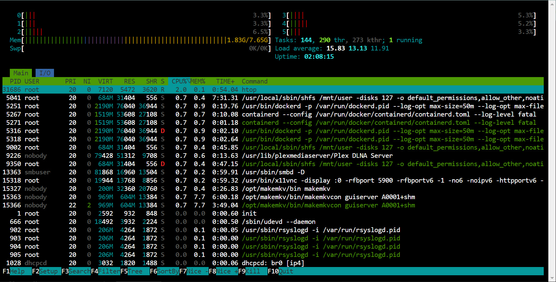

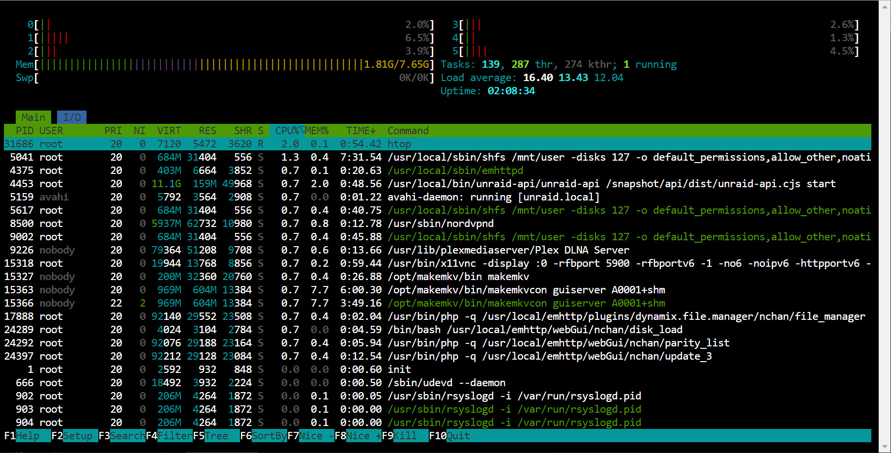

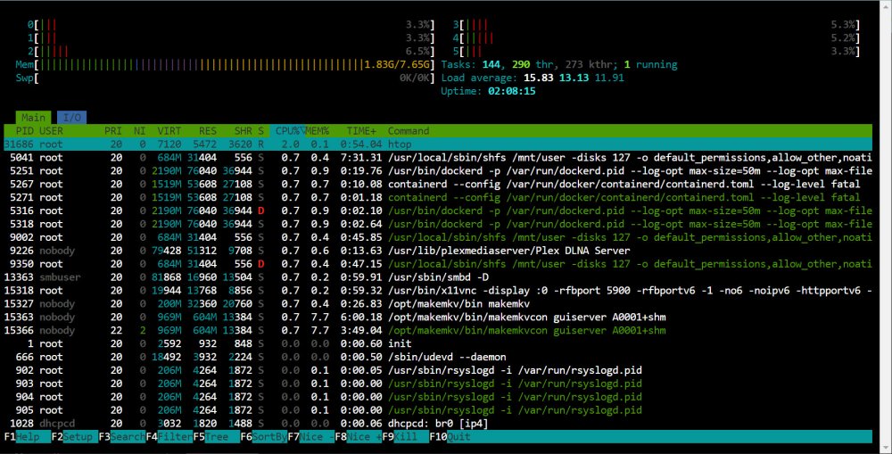

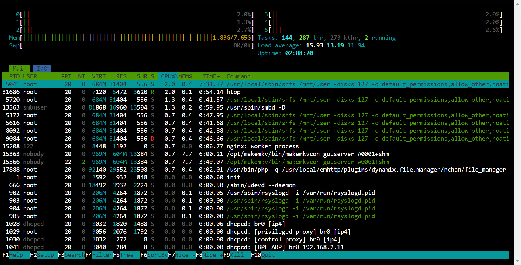

  • When rates drop there is a spike in CPU from resting 10% to 50%. Included some screen shots of what I see bouncing in the top CPU chart during the event.
