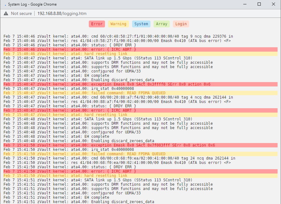

My newest HDD, installed within the last 6 months, failed last night during the parity check and went offline. After running a few tests on it and searching through past Unraid Forum posts I couldn't see any major issues except that both my two most newest HDDs had error counts in the millions from the parity check which failed about 80% of the way through. But only Disk 6 went offline, Disk 5 remains online and currently shows it is operating normally. I did notice that the memory allocated to the log was maxed out at 100%, so I shut everything down, rebooted, and I am currently rebuilding the missing disk back onto itself. As soon as I started the rebuild process (which appears to be working, but I'm super paranoid it won't) I pulled up the Log and noticed errors occurring over and over again. Looking through them it seems like the connection to the HDDs might be resetting repeatedly and I'm concerned that since two drives are connected via the same SATA Card that I might lose data since I only have one parity drive currently.
Hopefully someone with more knowledge than me can take a look and tell me if I'm barking up the right tree or not. Full diagnostic download is attached, but I also took a screenshot of the current errors I'm getting.

Connection problems with disk3.

Disk3 is the one I see in syslog now. I do see a lot of USB disconnects. You aren't trying to use USB connections for any of your array or pool disks are you?
