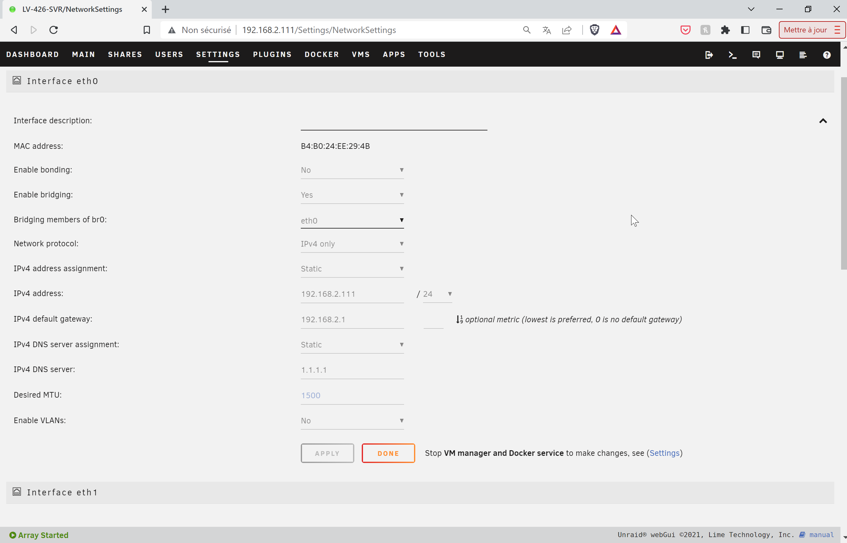

I stopped the array, configured the first NIC as follow:

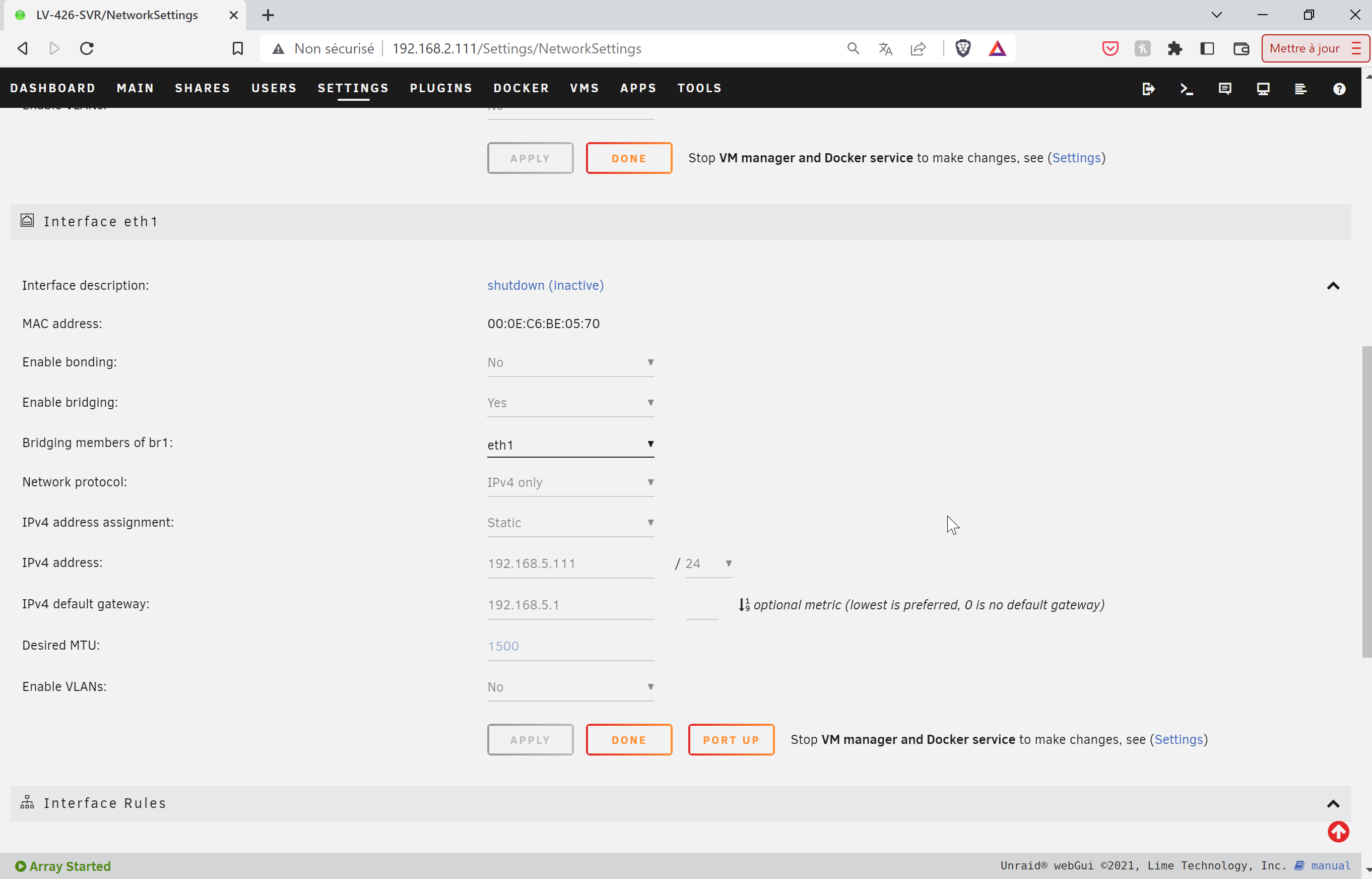

And I have the second NIC (actually it's a USB dongle) as follow:
I got some problems:
First, unRaid seems to think that my second NIC (eth1) is the default one and now my server cannot connect to the Internet.  I cannot update dockers, Emby is not able to get the cover art, etc.).  I have put the port down to try to resolve this to no avail.

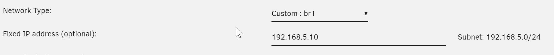

Secondly, with the port up and running, I tried installing the Shinobi docker and set the IP on the 192.168.5 network (br1):
But I cannot ping it and the web GUI gives me a timeout.

You did not turn on your eth1!
In "shutdown" state it is not very responsive... hit the "Port Up" button.
BTW: USB NICs are no good choice for UNRAID. Very few of them work, and even less of them work well and stable. Better try to get a simple and cheap PCIe 1x Card...
Edited by MAM59
Thank you for your reply!  I shut down the eth1 to try and resolve my problems but it didn't work and I left it down.  But what is weird is, even with the port down, I can still ping 192.168.5.111 (the static ip I gave eth1) in terminal, and it is still using this NIC to try and contact the Internet.  But that NIC is connected to a PoE switch which is not connected in any way to the Internet.  Is there a way to tell unRaid to use the other NIC by default for all things Internet?

Yeah, and a very simple too: DELETE the default Gateway entry on ETH1!
It does not belong there at all, only ONE default gateway can be active at a time. And only the card that is connected to the internet router should have one.
But I don't understand the ping if the port is down... or are you just pinging internally??? if yes you just get an echo from the driver himself, not from the card.

Yeah I was pinging from my unRaid server so I guess it's the driver that's answering.  I will check the gateway settings and report back!
Thanks again
Well I removed the default gateway on eth1 and suddenly unRaid saw all the available docker updates and such.  Emby can get the metadata and everything.  For testing purpose I put all my camera stuff on my main network (192.168.2) and configured Shinobi to start on 192.168.2.51 and now everything is working fine!  I'll just try to put my camera stuff on 192.168.5 later.
