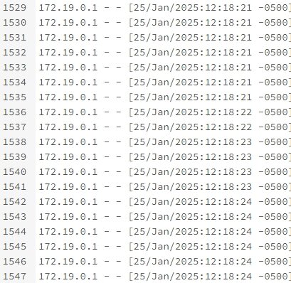

January 25, 20251 yr *READ* if you followed this guide but can still access your services after adding a ban decision. 1) Check your swag access log at: /mnt/user/appdata/swag/log/nginx For me, these were the IP addresses in the log. Obviously, this is incorrect since I'm connecting from my phone. 2) Navigate to: /mnt/user/appdata/swag/nginx 3) Add these lines to the nginx.conf file in the HTTP SECTION real_ip_header X-Forwarded-For; real_ip_recursive on; include /config/nginx/cf_real-ip.conf; 4) Also, ensure you have the Cloudflare real IP docker mod installed: linuxserver/mods:swag-cloudflare-real-ip 5) Restart SWAG and try connecting to your service. You can also confirm the IP by checking the access log again. Source: swag-cloudflare-real-ip
