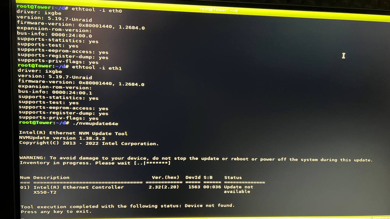

I attempted to update and i got this:
The package is wrong then, because it lists the x550-t2 but under status it says update not available, so I presume the firmware for that model is not included in that package.
I cannot be of more help here unfortunately, if I were you I would try to contact intel to ask how to update the firmware of that network controller.
Edited by ghost82
One thing to add to this is that the network card could be a intel one but not retail, for example sold by dell or hp, etc: if you look at your screenshot you will see 0x80001440 (this is your EEPID), which is not in the package you downloaded (file nvmupdate.cfg, both EEPID and REPLACES sections).
