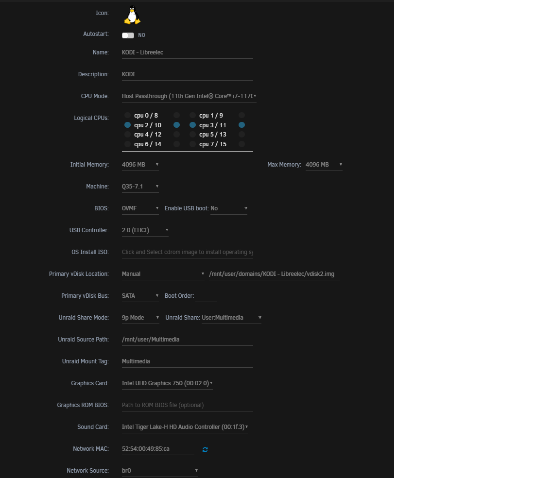

Anybody have an experience in implementing the Unraid Share 9p Mode within Libreelec?
There is no 9p mount script within Libreelec, like the scripts for SMB & NFS.
The problem arises when trying to mount the share within Libreelec, all the info I can find on the unraid forums talk about utilising "fstab" to mount the share but libreelec has no "fstab" function.

If it doesn't support fstab the only option you have is to manually mount the share somewhere:
mount -t 9p -o trans=virtio,version=9p2000.L,posixacl,cache=loose MountTag /path/to/mount/point
Maybe you can create a startup script in libreelec

I've ran your code in libreelec ssh to test 1st, but i keep getting an error
#                 LibreELEC                  #
#           https://libreelec.tv            #
LibreELEC (official): 10.95.0 (Generic.x86_64)
Wacko-Libreelec-Kodi:~ # mount -t 9p -o trans=virtio,version=9p2000.L,posixacl,cache=loose Multimedia /storage/test
mount: mounting Multimedia on /storage/test failed: No such file or directory

Would the capital M in Multimedia cause and issue?
now the message changed, it's no more no such file or directory but no such device, and it makes me think about the Multimedia tag, but I don't know what's wrong..
Edited by ghost82
ok I changed the unraid share mode to manual and edited the mount tag to multimedia  (all lower case) but still same error

I'm not sure libreelec is capable of mounting 9p..qemu wiki says to enable some things in the kernel configuration of the guest:
https://wiki.qemu.org/Documentation/9psetup
and since libreelec does not support running in virtualization environments I don't think it's capable..You may ask in libreelec forum if libreelec is able to mount 9p shares, but I think its default kernel is not configured to be able to do it.
Why not using any other linux distro and install kodi on it instead of libreelec?it seems it's such limited..It's very good for multimedia streaming, I run it in a raspberry, but in a vm, it would not be my primary choice at all.
Or why not using a smb share: it's true that 9p should be able to give more performance, but there should be not such a difference..
