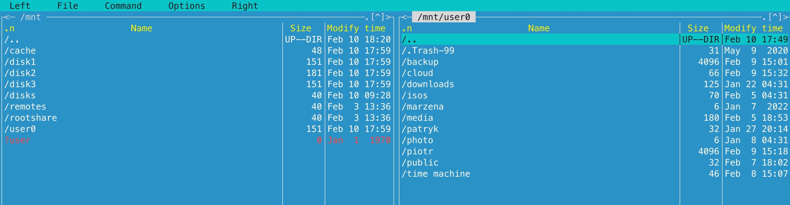

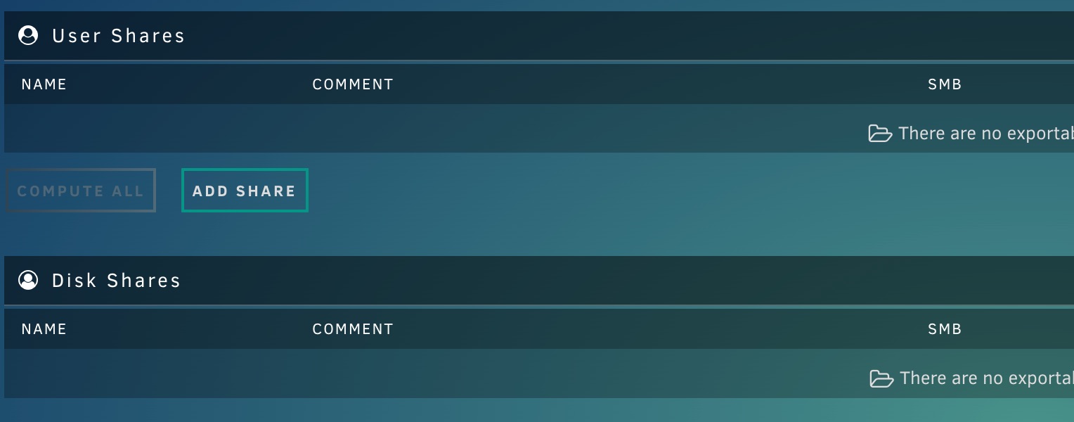

Everything looked ok. I separated the disk, created the cache again. After starting the array and set my shares as they were, I decided to help the mover copy the files (it took 8 hours to move from the cache to array) so I logged in via ssh and decided to help the mover a bit and copied the files manually via mc (Midnight Commander) from disks to cache. And I lost my user shares:
user directory become user0 and all shares are there. And that's my problem (except for my stupidity). Symlinks are gone or so... Can't rename user0 to user or remove user? Error: transport endpoint is not connected(107). Help please...
Both exist normally, reboot and /mnt/user should come back.
Yes. Reboot helped. All shares in places. Big THX JorgeB. Can I safely move everything from user0 to user and delete it?
No, both are normal.
NO!   If you try that you will lose all your files
you should read this section of the the online documentation accessible via the ‘Manual’ link at the bottom of the GUI or the DOCS link at the top of each forum page.   It explains the role of the /mnt/user and /mnt/user0 mount points.
Yeah, actually I did now. Thx again for help guys.
