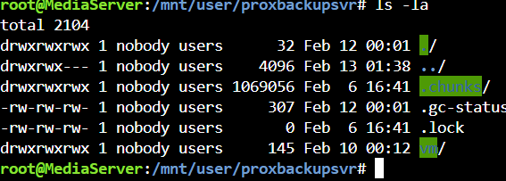

Permissions for the proxbackupsvr share on unraid
Your permissions on the proxbackupsvr directory are 770   and they should probably be 777.  What are the permissions of the files inside of the .chunks directory?

chunks are i believe the contents or "snapshots" of the proxmox vms that the PBS takes and puts in there since thats where i directed it to put it in the share. How would i go about changing it to 777 would that fix it?
