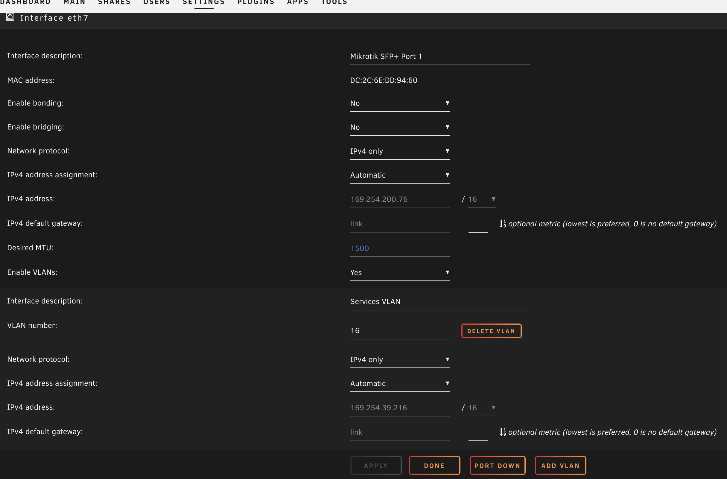

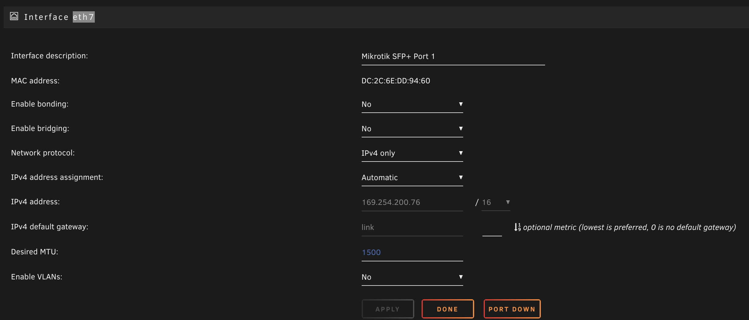

The issue is that for all of my ports, except for VLAN 1, it pulls the self-assigned IP (169.254.200.76/16) instead of pulling an IP from DHCP, as seen in attached screenshot named "Unraid SFP+ Interface." When I check "Enable VLANs" and put in the VLAN ID (16 in this case) it does the exact same thing for the VLAN sub-interface, as seen on the "Unraid SFP+ Interface with VLAN Set" screenshot. When I SSH into it and run "ip addr" then it shows the exact same thing with the interfaces being up for both the eth7 and eth7.16@eth7 interfaces having that self-assigned IP.
