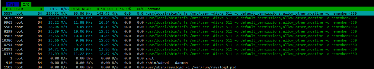

I've had htop running for a couple days and watching it, and I see crazy ups and downs (see attachment) that's one of the crazy bursts, where it seems like all the processes are doing awesome with the stuff they're supposed to do. But then I'll have periods where only a couple are even over 1 M/sec.

6 hours ago, u0126 said:
It seems like I'm hammering these disks from 3 rsync over SSH streams
Does this mean you are writing to 3 disks at the same time? You don't want to do that with parity, it will be extra slow, also look a turbo write for initial server load, but note that USB is not recommended for array and pool devices.
I'm writing to /mnt/user shares. I'm showing the behavior of what htop and the I/O subsystem is reporting. I'm not trying to subvert Unraid at all.
