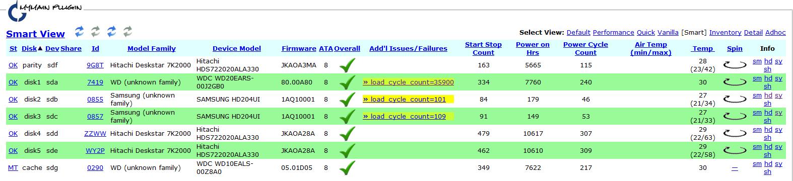

Well, looks like I get to eat crow ;).  I've been ignoring the advice to adjust WDEARS drives with wdiddle because I hadn't personally seen any issues with the several WDEARS drives I've been using for months.  Well, now it looks like I finally am starting to see some problems:
(click for full size)
I just noticed the issue, so I haven't had a chance to see if the LCCs are continually increasing, or if they are stable at those numbers.  I'll compare them to this screenshot over the next few days and weeks.
Obviously I want to avoid all of these WDEARS drives failing at once.  Should I start preemptively replacing them?  I do have a single 2 TB Hitachi I could throw in the array right away.  The others would have to wait a few days or weeks.
Also, I know about the HPA on the cache drive, and I don't care to fix it.  It isn't harming anything.  The parity drive's errors have also been stable for a long time, so I'm not too worried about it either.

I set the LCCs in myMain to go off at a pretty low level so that people would see them before the numbers got crazy high.  There is nothing you can ever do to lower them - but you can slow down the increase.
BTW, if you set the "hpa_ok" attribute to 1 on the drive settings page, you can turn off that HPA warning.  Just click on the drive's ID (last few digits of the SN).  The drive settings dialog will open.  Under the bottom setting (Other Notes) enter hpa_ok, and to the right enter 1.  Click save.  Go back and refresh and you'll see that the warning is gone.  Just don't forget if you want to assign it to the array.

Wow, i'm glad I ran across this today.  I had not heard
I have one WD20EARS and it has 35900 LLC's for 7759 pwr on hours.
Is this enough to get WD to RMA the drive?  You just tell them it has high LLC's?
I did find a note in another forum (reading on this issue) that said the specified limit is 300,000 or in another place it said this was the minimum at which the chance of a problem increases.  At what point would they RMA the drive?
Also, where do you find the correct wdiddle to use with this drive?  The only one I could find on WD's website is

I also noted this count is coming up on my Samsung green drives, though notably much smaller numbers.  The WD has 4.6 cycles per hour of use and the Samsungs are starting out with about .5 cycles per hour (they are really new).
Is this typical for any green drive?  Should I do anything with the Samsung drives?
