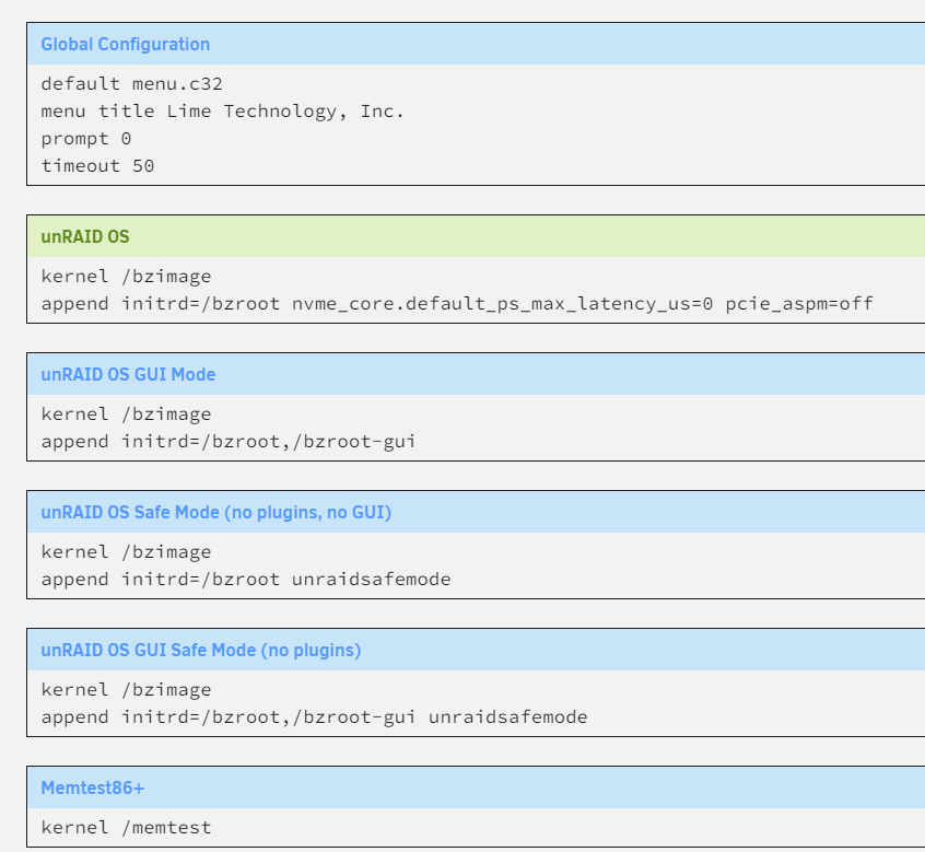

Thank you so much for the response! I added that to my flash config and am rebooting the server now. My docker and VM images are jacked again, so I will reconfigure them with this setting enabled and see if all drives can finally be reliable.
If I wanted to add this to the GUI boot option as well, would it be the text below or do I need a comma?
append initrd=/bzroot,/bzroot-gui nvme_core.default_ps_max_latency_us=0 pcie_aspm=off

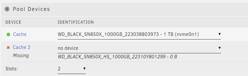

Sadly, one of the drives disappeared with this setting enabled while i was running the cach pool BTRFS scrub/repair. But they are still connected via the Highpoint card so maybe I need to put them back into the M.2 slots with this new setting.
just add the text after a space.
