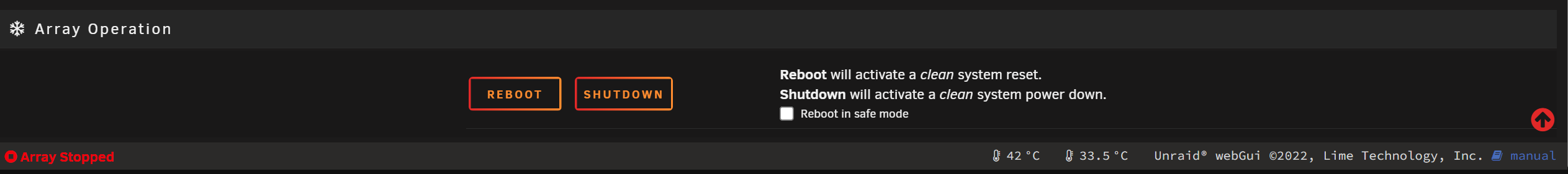

After a server crash I performed a parity check and rebooted. Now I cannot start my array. The button is not even shown in the WEBGUI (see attached screenshot).

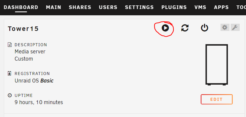

This is a known issue, but don't know the cause yet, you can go to the dashboard and start the array:
And the normal buttons should come back after that.
