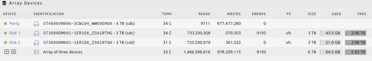

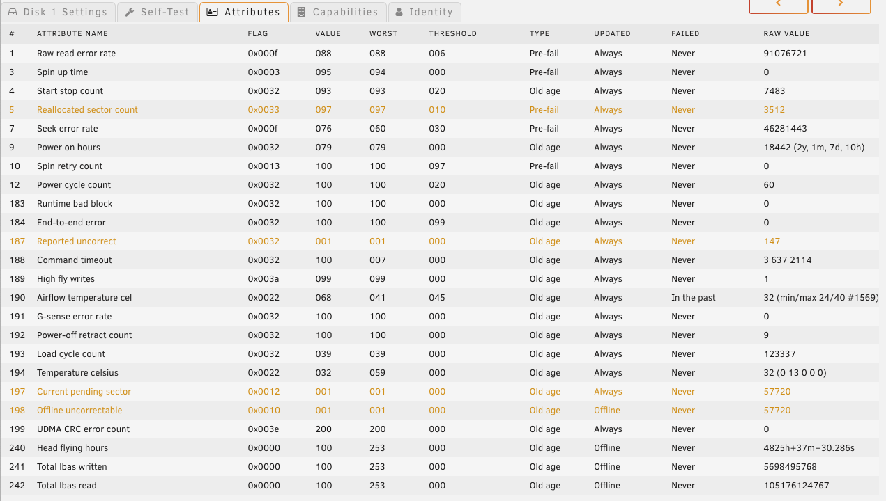

I have one disk in the array that's reported 9000+ errors (particularly when setting up the array).
I run an extended self-test and it stops at 10% with "Completed: read failure"
When I look at the SMART report though it suggested the disk "Passed."
How can that be?  Is the disk usable?  Unraid is not reporting failure or need to replace etc.
The SMART report is attached.
Thanks for any suggestions.

Num  Test_Description    Status                  Remaining  LifeTime(hours)  LBA_of_first_error
# 1  Extended offline    Completed: read failure       90%     18441         886976
# 2  Short offline       Completed: read failure       90%     18441         886976
29 minutes ago, AshleyAitken said:
Is the disk usable?
no

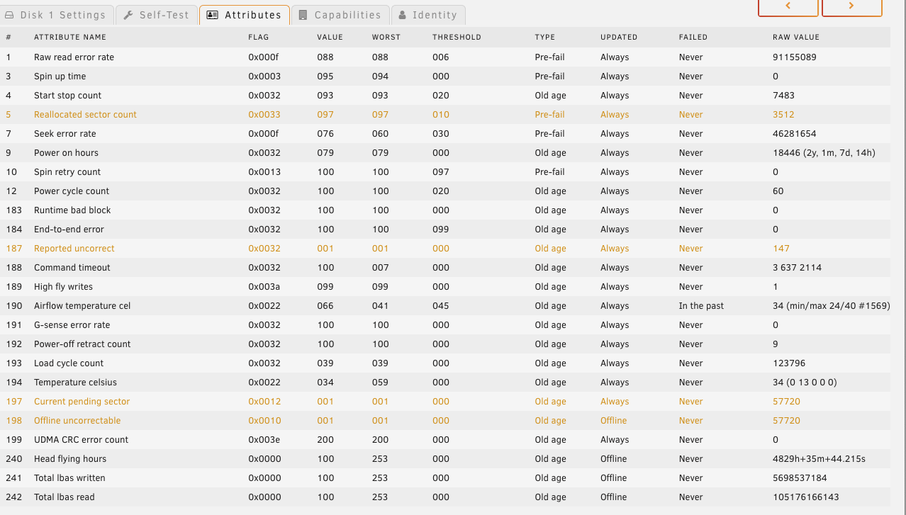

Also, you should be seeing SMART warnings ( 👎 ) on the Dashboard page for that disk. And if you click on the disk to get to its Attributes, these would all be highlighted.
ID# ATTRIBUTE_NAME          FLAGS    VALUE WORST THRESH FAIL RAW_VALUE
  5 Reallocated_Sector_Ct   PO--CK   097   097   010    -    3512
187 Reported_Uncorrect      -O--CK   001   001   000    -    147
197 Current_Pending_Sector  -O--C-   001   001   000    -    57720
198 Offline_Uncorrectable   ----C-   001   001   000    -    57720
Do you have Notifications setup to alert you immediately by email or other agent as soon as a problem is detected?
Post diagnostics if you want us to take a look at your hardware and configuration.

The disk does report these attributes:
and in more detail:
Those "Pre-fail" look ominous 😞 and probably mean I should replace the disk?
But still I am confused why SMART reports "PASSED."  Surely it should be saying something like "going to fail" or "replace"?

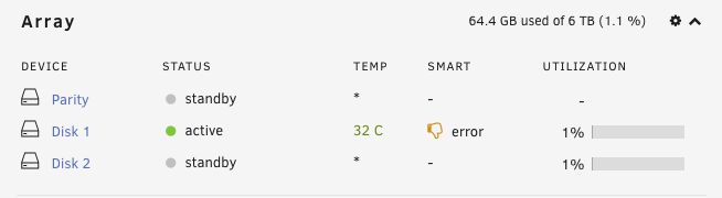

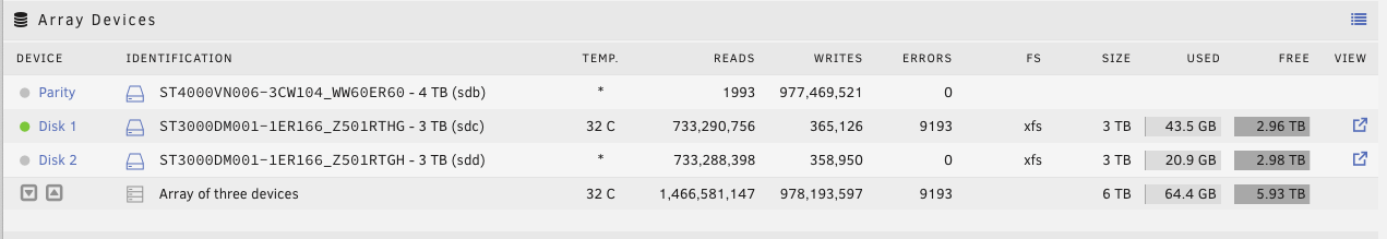

Disk 2 now also showed an error in the main dashboard.
But strangely no errors show on Main page.

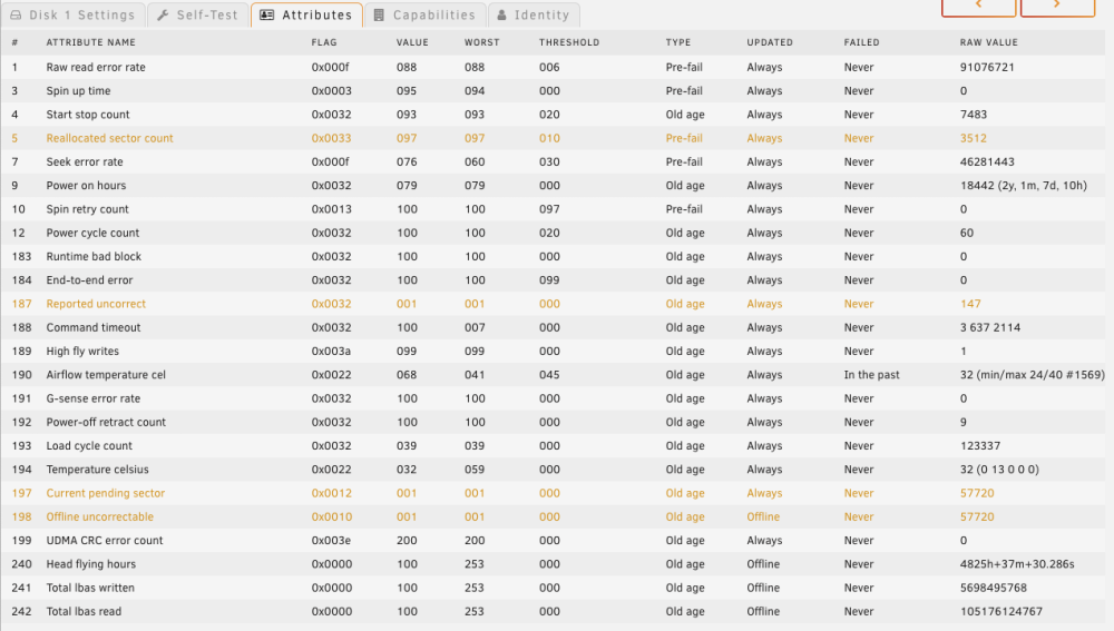

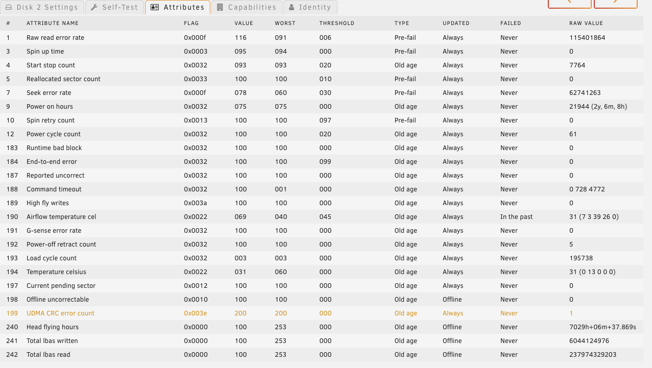

The attributes for each disk show as:
Why do they show "Never" for Failed column (except for airflow temperature)?
UDMA CRC errors are recorded by the drive firmware when it receives inconsistent data based on checksum. These are almost always connection problems. Usually the data is resent so no harm, but you do need to fix something if they increase frequently. And often, a connection problem will not result in CRC error because the drive never receives any data to checksum.

Here's an other example:

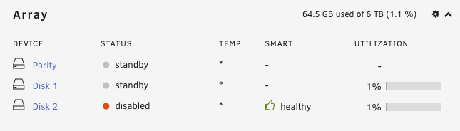

Disk 2, which has been the better disk so far, has now had 22 errors/warnings and shows this in the dashboard.
Why is it "disabled" when SMART is showing healthy (after errors and warning)?
Unraid disables a disk when a write to it fails for any reason. Often this isn't a problem with the disk, but a problem communicating with the disk. That failed write updates parity, so it can be recovered by rebuilding, but the physical disk isn't used again until rebuilt since it is now out-of-sync with the array. After disabling, the disk is emulated from parity,
When reading an emulated disk, the data comes from the parity calculation by reading all other disks. When writing an emulated disk, parity is updated as if the disk had been written. The initial failed write, and any subsequent writes to the disabled/emulated disk, can be recovered by rebuilding.
