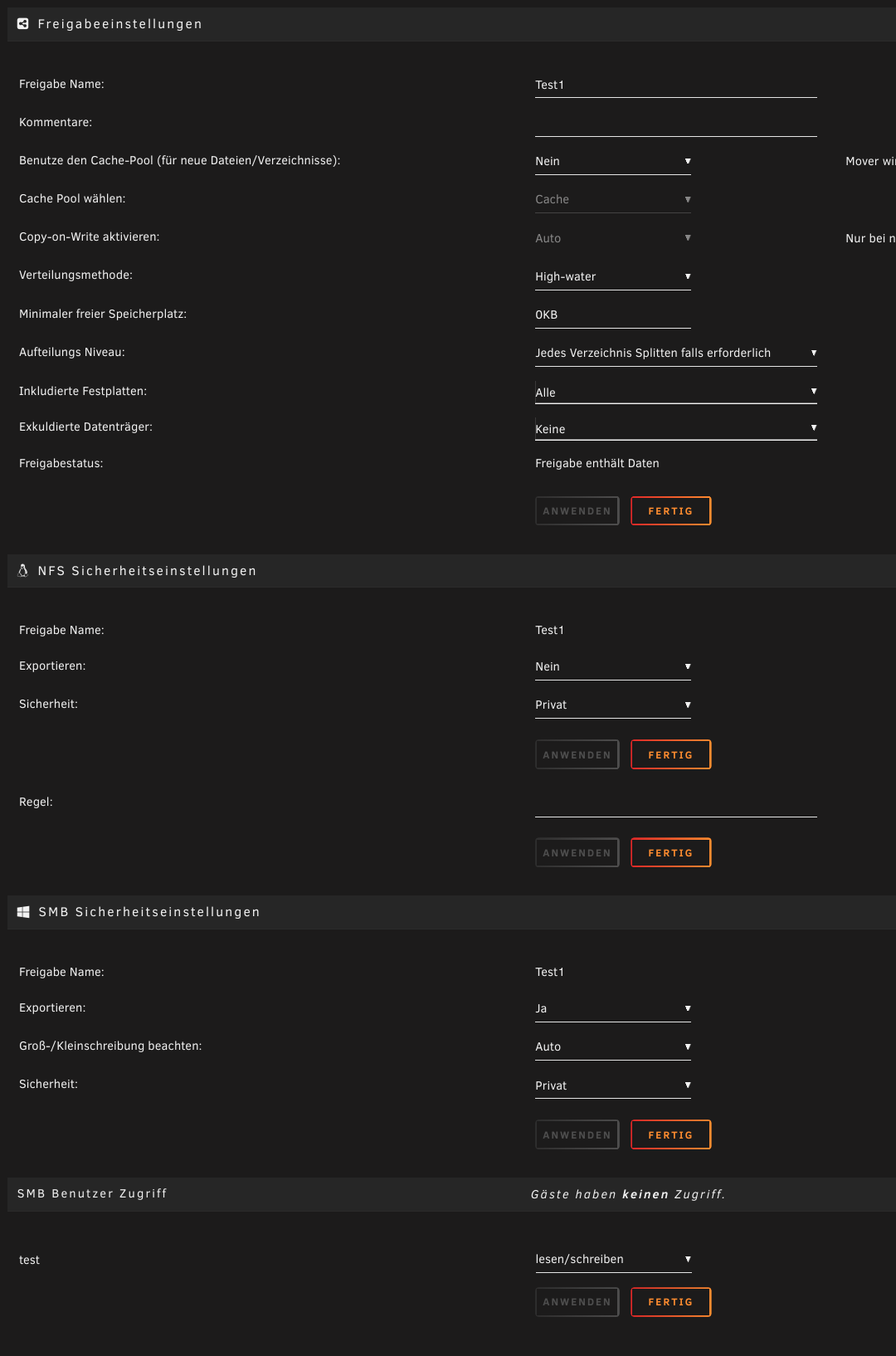

I have Problems with the Access to Protected SMB Shares. For example Secure and Private Shares with User Credentials.
On the German Area I have found no Solution. Maybe have a anybody here a Idea.
On Clients like a PC or Mobile Device its doesn't work.
On the Linux client like Manjaro with Arch or Ubuntu gets when mounting by fstab, mount .... permission denied as error returned.
If I tried via the file manager, like  Nemo/Thunar, Nautilus, the login window showed again after typing the Credentials on it.
On the Android phone I become in the FolderSync Pro App a Access Denied message.
If the share allows guests like Public or Secure and does it without credentials/anonym or with the user Nobody, then it works. (Tested on PC) Including write access by Public Shares. With Secure Shares guests have only read access.
IP or Servername is the same Situation.

    Those three ticks are your problem.  The permissions should be as shown below:   You have to have rwx permissions for both group and other for SMB to work properly.    I woul

Post a screen shot of one of your shares you are trying to share Private.  That would be the 'SMB Share Settings' page of the share.
I changed the test User to Read/Write Access and tested the Connection. Same Access Denied Message. I send you a new Diagnostic.Screenshot_20230227-152437_Firefox.thumb.png.072b83a4cf6af94c949c596c892aeac1.png
Edited by Revan335
That's what I wanted you to figure out.  You didn't have any users defined for any shares.  It should be working now.  Be sure to use the Windows Network to browse to the share, and access it that way.
If you are still having issues, post the output of this command:
testparm -s
