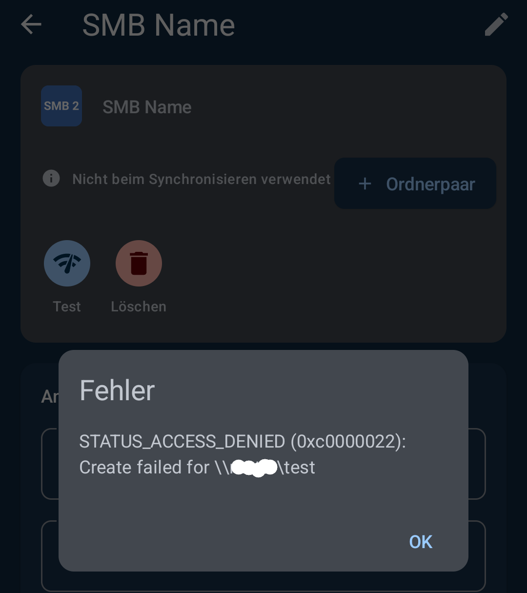

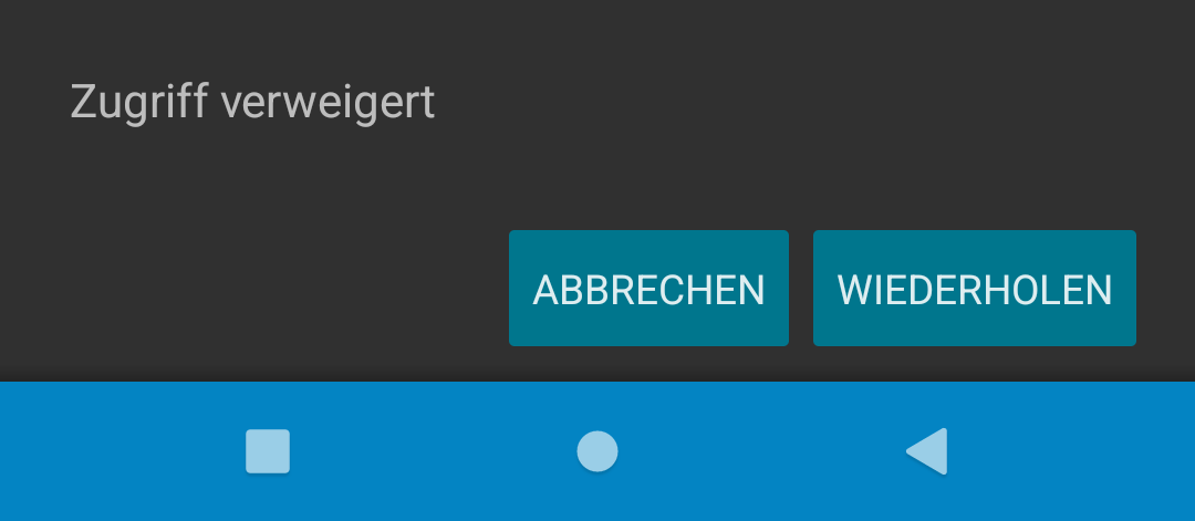

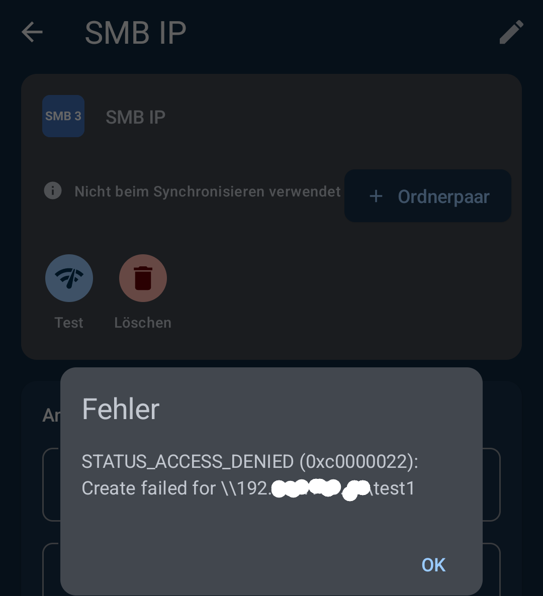

Sorry, Dont Work.
A Win VM:
1838070045_Bildschirmfotovom2023-02-2720-37-57.png.9b6ff43dbfe1df239a050ac4c77f327e.png2012885203_Bildschirmfotovom2023-02-2720-37-02.png.e475098db9fb9df042728d9e3d471a75.png
Android Handy:
1880916848_Screenshot_20230227-204626_SolidExplorer.thumb.png.414362cdcb5c6f25c9e4338cc49495f3.png1612248075_Screenshot_20230227-203532_FolderSyncPro.thumb.png.906cba0004315220bd1d0043eda1d8b9.png94044555_Screenshot_20230227-205353_FolderSyncPro.thumb.png.e7d9e72f1749869c38244897a6cea4f7.png
Linux (Manjaro Arch Linux), Ubuntu dont work too:
483272904_Bildschirmfotovom2023-02-2720-36-25.png.d12c15ce1eb9a3f31db081a1e320e8b0.png

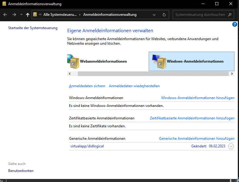

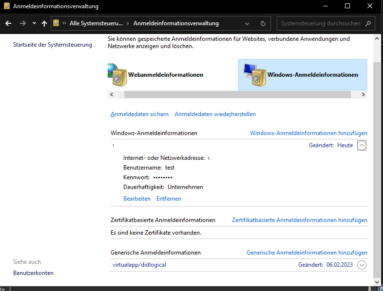

Make sure that you have setup a 'credential'  for your server in Credential Manager for the User 'test' on your Windows computer.  This must be the only credential to that server!  (Delete any other credentials for your Unraid server!)
Always run the following command on the command line of the Command Prompt App on your Windows computer before you test any configuration change-- on either the server or the Windows computer.   (This command will cause a complete reset of the Windows network--  Basically the same as rebooting the Windows Computer.)
net use * /delete
net use * /delete

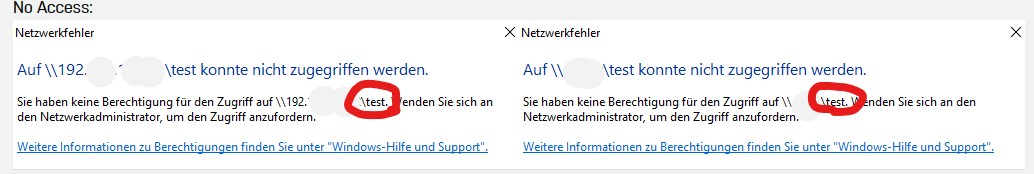

1507405864_Bildschirmfotovom2023-02-2722-29-50.png.2f157032304d9e20053fac3ed04b6e38.png
105001235_Bildschirmfotovom2023-02-2722-30-14.png.59e7586cd75bcba89032ee0472710b72.png381930661_Bildschirmfotovom2023-02-2722-31-39.png.dba21e09dafaafd32c0797636548696e.png
No Access:
I tried with name first.
Than remove the name, used the command/reboot.
Put the IP + Credentials in the Credential Manager, used the command, tryed the Access with the IP Adress to the Share.

I tried with Test Share, test User and Unraidname like Tower not tower on Android. The same errors.

Remember to run that command to disconnect all network connection before you try the following!

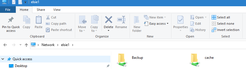

Open up Windows Explorer.   On the URL bar, type     \\<server_name>    and hit the enter key.    You should get something like this:
If you don't, get a screen capture of what you do get, showing the above and be sure to include the error message.  (Don't worry about what is in the screen capture.  If you have a router with a decent firewall, any information that is displayed would not be useful unless someone had access to your LAN (Local Area Network) who should not have access to your LAN.  If that were the case, they already know more that the requested screen capture will show!)
Also let us know what Edition and Version of Windows you are running.  Example   Edition: Windows 10 PRO Version: 22H2
Win 10 Pro 22H2 Bare Metal
308795839_2023-02-2807_40_29-Raster.png.14192092b0d0c0dc9dd70887a6c5049f.png807787708_2023-02-2807_40_40-Raster.png.a61b2f3a04901565f5b1edc562396d3e.png

6 hours ago, Frank1940 said:
Another thing that most people don't realize is that Windows will provide a 'user name' and password whenever requested by the server.  If there is not a credential in Credential Manager, it supplies one from a predetermined list of candidates.  If that fails, SMB will attempt to establish a 'guest' login connection.  That will often succeed with Unraid.  You now have a login to the server and depending on the security settings (Private, Secure or Public) of the share, your access are limited to 'guest' privileges for any share on the server. (This process is why Mapped Drives can be automatically connected at the startup of your PC.)
Yes, the test User is with PW and name in the Credential Manager.
Don't forget to delete all of the network connections with that Windows command when you change anything.
Yes, i used the Command and Reboot of the Machine.
I have no Fastboot activated on Win.
It doesnt work.😭

I deactivated the Guest Login per Policy but i don't have Access again.
I'm using the dumkopf User and entered it in the Credentials Manager.
You don't have Permission to Access \\Servername\test
Is SMB/SAMBA not Open Source or Reversed Enginered and that's why implemented in Linux, Kernel?, Distributions and .....?

Strange the Private Share of flash (Unraid USB) its working included Login.
Can the Array/Disks have a "Macke"/Problem with anything that's are the Root of this Evil?

31 minutes ago, Frank1940 said:
Try running the 'New Permissions' script in the TOOLS menu.  Run it only on the User Shares that you are trying to access via SMB.
On Android no Change.
I tried in Win/Linux later.
The working flash was tested on Linux Mint.
