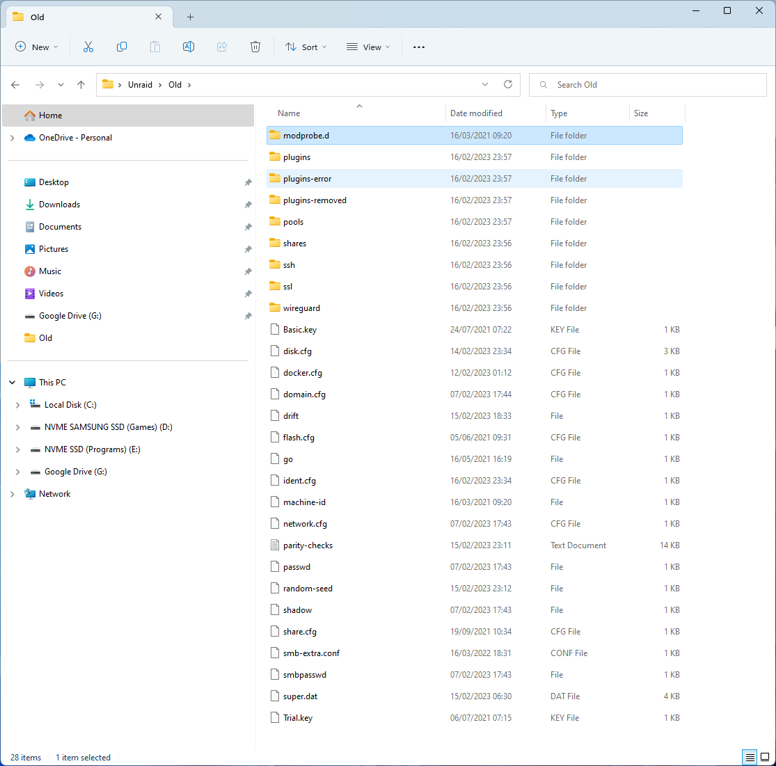

I have a partial backup of the folders, but for some reason the config folder is missing...  This is what I have below. Will salvaging any of this help?
That is the config folder
Copy all of that to the config folder on a new install
Edit disk.cfg to disable autostart
Boot and post a screenshot of Main - Array Devices

Ahh right, so it is. Thank you.

I'll take another look at the link now re: identifying the parity, thanks.  Would I also need to copy the "shares" folder from the old config to my new one, or is that something that will pull through when setting the drives back up?

Your disk assignments are in super.dat in the config folder.
Managed to resolve it. Thanks!
