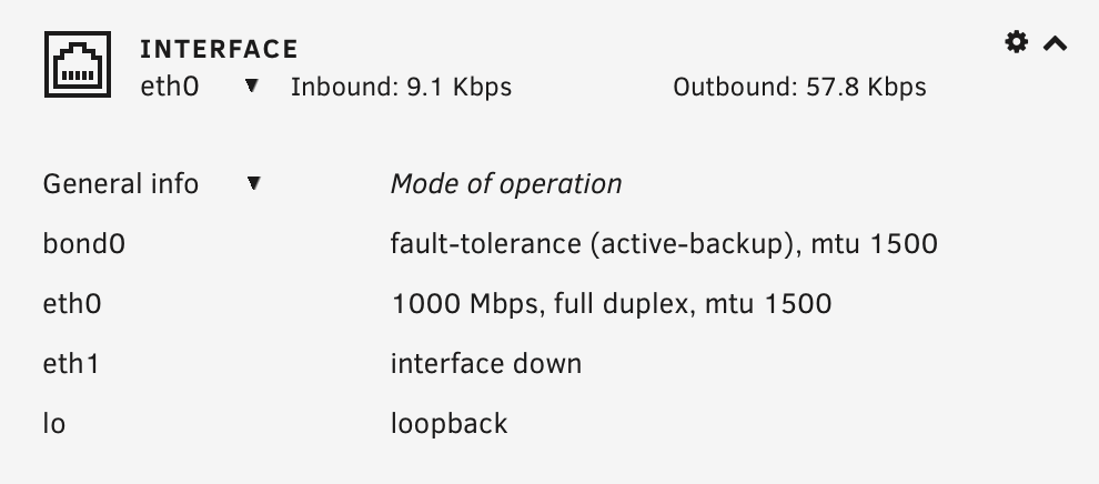

There is, however, one issue that I'm running into that I seem to be unable to resolve. Namely my network connection (LAN) is only showing as 1000Mbps despite my hardware supporting 10GbE.

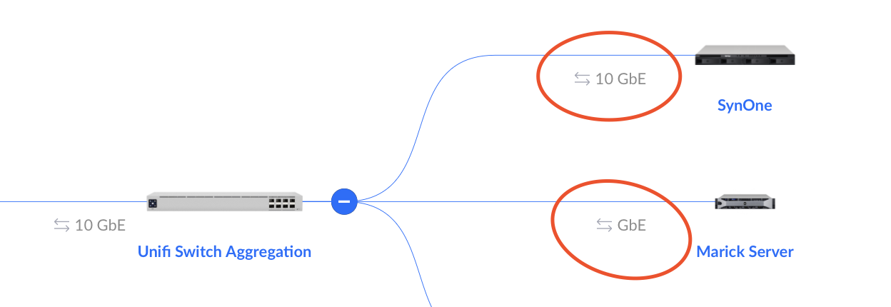

My Mainboard has a 10GbE ethernet port and is connected to a 10GbE compatible switch (same as my Synology RS820+ which is also equipped with a 10GbE NIC).
Attached you will find a screenshot from the Unraid dashboard as well as my Unify console readout.

I guess, you need to disable bonding for the interface eth0.
Although eth1 has no cable yet, putting both interfaces into a single failover bond (or aggregation) may limit the maximum speed to the highest common speed of all interfaces that belong to the same bond.
(but I don't know UNRAID's internal network setup, so this is a GUESS, but you can safely try it out)
Otherwise check the cabling, looks like it just gets an 1Gbe Link, maybe lousy cables or too much noise.
