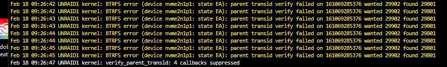

BTRFS error transid verfify failed - 2 callbacks suppressed
I woke this morning to find most of my dockers stopped, it looks like ca backup stopped my dockers ready to backup as the backup folder was created but it is empty and I can see all these BTRFS errors on nvme2n1p1 but I cannot work out which physical drive this is?  This is the 3rd nvme related problem I have had on this new motherboard in as many weeks so really need to get to the bottom of it, any help will be greatly appreciated!

There was some previous data corruption on the pool detected by btrfs, and now there's this error:
Feb 18 03:43:10 UNRAID1 kernel: BTRFS error (device nvme2n1p1): block=161059291136 write time tree block corruption detected
This means new data corruption was detected before writing the data to the filesystem, and it's usually a sign of bad RAM, start by running memtest, then post new diags after array start.

Thank you @JorgeB
1, I have run the memtest which passed but I have another 4 sticks which I have now replaced the existing RAM with.
2, You say there was existing corruption? how do I address that please?
3, Is this not an NVME problem then? "BTRFS error (device nvme2n1p1): block=161059291136 write time tree block corruption detected"
4, I will look into ipvlan now.
Thanks again!
Post new diags after array start.
Run a correction scrub on the pool to see if any errors are detected, if there are uncorrectable errors post new diags after the scrub.

And cache pool also, since the write aborted because of corruption was on that one.
ok, so have scrubbed all 3 pools and no errors found on any of them!
That's good, see here for how to reset stats for cachetwo, then see also there how to better monitor the pools, if more corruption errors appear you likely still have some hardware issue.
