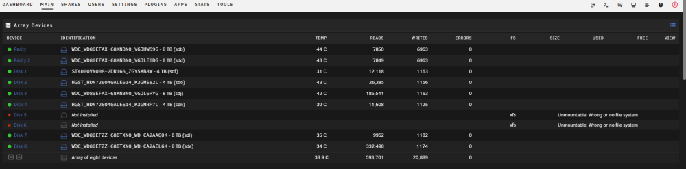

Hi all,
Been running unraid forever but fairly green. Starting last week, Ive had drives start reddballing. I assumed bad drives and just replaced them and rebuilt them.
Now however I looked into my server this AM when I thought all was good as I t was all finally green and working last night. seemed to be humming along perfectly. Jow however, I have 3 drives redballed so that's beyond rebuild capability of dual parity.
How can I proceed? IS there a way to force it to recognize these drives as good to minimize data loss? I am not sure how to proceed.

to make matters worse this started as 2 redballs so I started rebuilding a drive when another dropped so I have a drive which I know is scrapped. (cause I panicked and rebooted everything via shutdown) However, is there a way to get the other 2 drives be known as good and rebuild that one?
OK, so since I'm a panicky idiot. I rebooted before grabbing a diagnmediawhore-diagnostics-20230219-1302.zipostic and also posted before seeing the rules. Here is diagnostics however. Running Unraid Pro 6.11.5
Edited by Deryg

I have no issue replacing those 2 drives. I mean, I guess I have horrible luck (although we did have some wicked power outages and storms recently. This will make 5 drives replaced in a week.
I may as well grab drives and sata cables and replace the lot. I detest the current SATA cables
However, it leaves me with the question of: Iis there a way to force disk 7 as good (I am almost positive it is) so that I can rebuild disks 5 and 6? currently with 3 drives dead, I can't even begin corrective measures as I have invalid configuration (too many drives missing).
This is where I'm stuck. How does one proceed to fix an array with too many drives gone off
Thanks for the assistance
Do you have those drives? Bad connections are more common than bad disks. Though in your case that might not be true since you apparently didn't know you had bad disks
You must setup Notifications to alert you immediately by email or other agent as soon as a problem is detected. Don't let one unnoticed problem become multiple problems and data loss.

Do you have spare disks to replace those bad ones?
Save me the trouble of examining all your other disks. Do any of your disks have SMART warnings ( 👎 ) on the Dashboard page?
Your cache disk is reiserfs. You really should put an SSD there anyway so maybe we will do that over after getting your array stable again. Disable Docker in Settings and leave it disabled until further instructions.

You have several WD disks. You should go to the settings for each of those and add attributes 1, 200 for monitoring on all WD disks. One of those have a few on attribute 1, so you will get a warning for that one after you set that up. I think it is OK to just acknowledge that for now by clicking on the SMART warning (👎) on the Dashboard page and it will warn again if it increases.

Diagnostics after reboot, so can't tell what happened before, but disks 5, 6 do have troublesome SMART reports. Possibly bad connection on disk7.

the problem is that I had started a rebuild on drive 6 when it all went to shit. as it was in the process of rebuilding, I assume that one is toast and unrecoverable?
Damn, i forgot today is a holiday, so no replacement drives can be bought. all the stores are closed. Array will remain offline for another day. anything I can do in the meanwhile?
I'm still unclear as to how to proceed as well once I do secure some new drives and cables.
I did reseat my card (PERC H310), and reconnected all drive cables in case I had bad connections.
Were you rebuilding onto the same disk? Even if so, might be recoverable.
You are in a situation similar to many we have helped users with, sometimes with no data loss, sometimes with some data loss, or at least with some data that needs to be examined and put back in the correct place.
