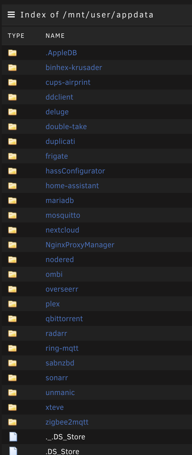

Going to install that now.. I currently have all the folder I would suspect on the array – just seems weird the last modified dates are super old for everything. Screenshot attached of the folders.
So yeah currently my appdata folder is set to "Only : Cache" which I'm guessing is incorrect, and means that my appdata folder never gets copied back to the array. So the only way to remedy my Plex situation (all others are backed up) would be to potentially get the files off the cache before formatting? Is that even possible?
If you didn't have the default shares as cache:prefer, then they probably wouldn't have been recreated. If these shares were cache:no or cache:yes, they were probably already on the array.
