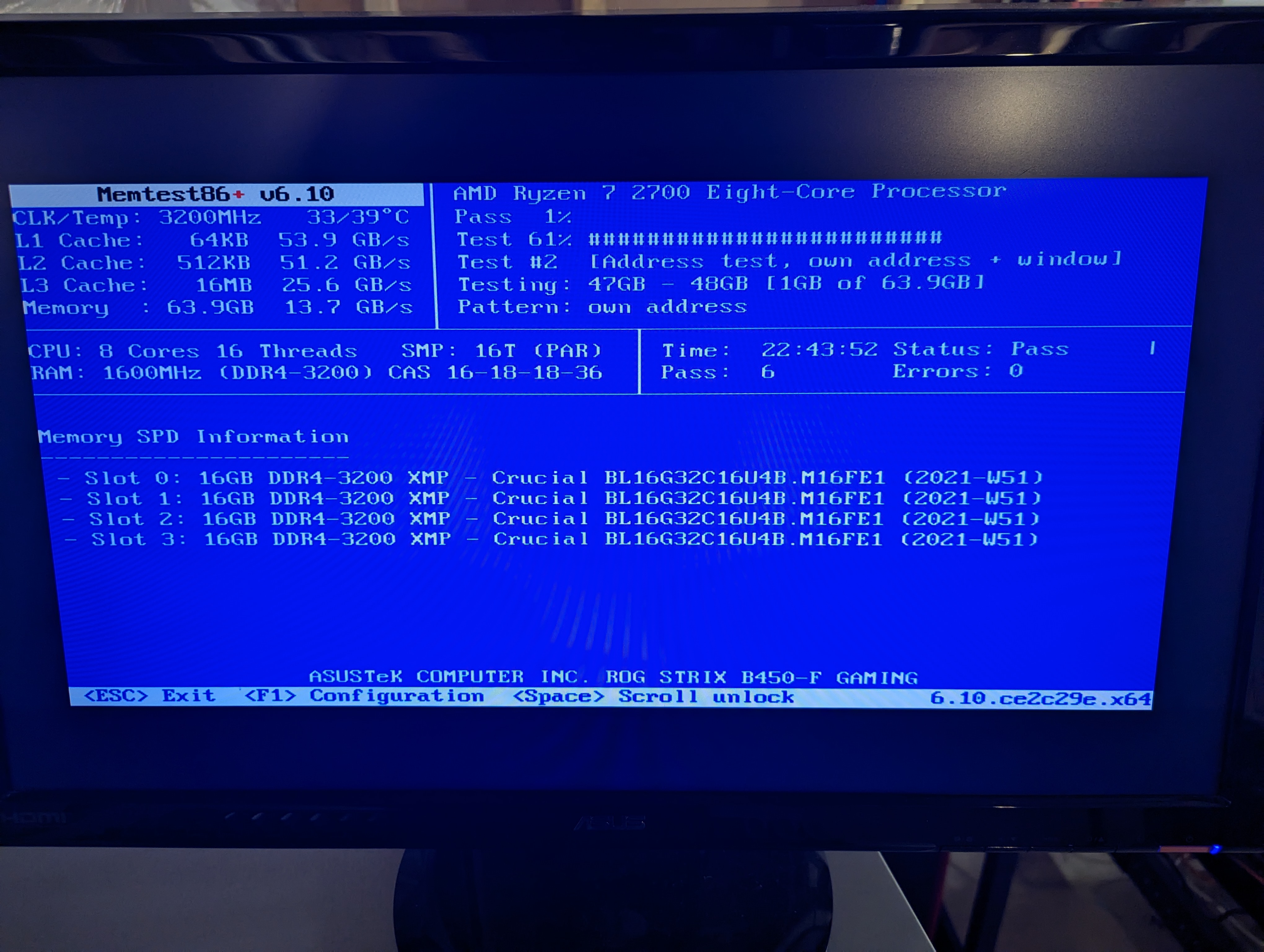

A little early on the 24hr mark, but my memory passed 6 sets of the 10 tests in memtest86+ ver 6.10. Prior to kicking off the tests, I did reseat the 4 modules just to be sure they were properly secured in each slot.

Hmm ok. So given that the memtest ran without any errors in almost 24 hours, could I be looking at a false negative with this test? I'm just at a loss at trying to figure out what the issue could be at this point. The server was completely stable when I was on 6.9.4 and really only started crashing when I upgraded to 6.11.5.
