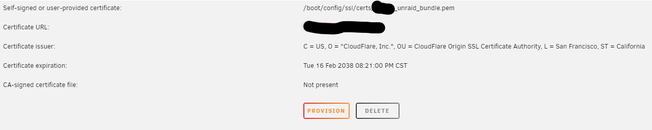

I use Cloudflare and have a wildcard certificate that is tied to my domain name.  I would like to use this with unraid, but am experiencing issues importing the cert.
When I add the certificate to /boot/config/ssl/certs/hostname_unraid_bundle.pem and navigate to the server in the browser, I get an ERR_CERT_AUTHORITY_INVALID error.  Inspecting the Cert does show the custom cert in the browser.
I can see it in the /Settings/ManagementAccess page, but it also says: "CA-signed certificate file: Not present"
I found the directions in the wiki, but they are lacking information on how the /boot/config/ssl/certs/hostname_unraid_bundle.pem file should be structured.
I get separate Certificate, Key & CA files from Cloudflare and I need to combine them into the _unraid_bundle.pem
Also, cloudflare gives me certificates for "Edge", "Origin" and "Client", I'm using the "Origin" certificate.

In case anyone stumbles upon it later on:
The Cloudflare certificates only work for Cloudflare services. Theyre not "real" certificates. They only work between your service and the servers of cloudflare.
ZeroSSL or LetsEncrypt are the way to go.
