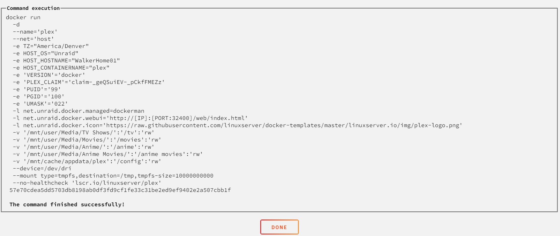

Perhaps you have some host mapping into rootfs. The OS runs in rootfs and if you fill that the OS won't have any space to work in.
Post docker run
Docker run screenshot attached (if I did it right).
