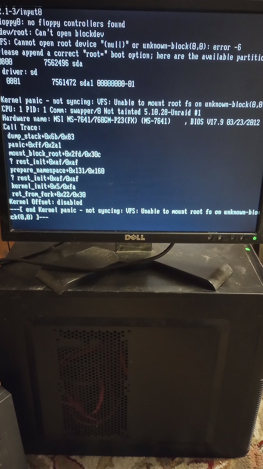

I'm getting a kernel panic on boot on the machine:
Kernel panic - not syncing: VFS: Unable to mount root fs on unknown-block(0,0)
CPU: 1 PID: 1 Comm: sapper/0 Not tainted 5.10.20-Unraid #1
Hardware name: MSI MS-7641/760CM-P23(FX) (MS-7641)   , BIOS V17.9 03/23/2012
Call Trace:
  dump_stack+0x6b/0x03
  panic+0xff/0x2a1
  mount_block_root_0x2fd/0x30c
  ? rest_init+0xaf/0xaf
  prepare_namespace+0x131/0x160
  kernel_init_0x5/0xfa
  ret_from_fork_0x22/0x30
Kernel Offset: disabled
---[ end Kernel panic - not syncing: VFS: Unable to mount root fs on unknown block(0,0) ] ---
Yes, this is old hardware.
No, the machine hasn't been on for a year or so, therefore the version of Unraid is old.
No, I won't be unreasonably sorry if I have to upgrade my primary server to pass its MoBo on down to my backup server.
However, if anyone has any idea about a possible recovery solution for this, I'm all ears.
I don't have diagnostics, since the machine hasn't booted fully for me to get to the GUI to run them. If there are any logs being written to the USB boot drive, I'm happy to pull them and post it here.
I'm attaching a photo of the last bit of what's on the display. Maybe there's an issue with the lines above and I may have a possibility of recovery?
This is usually a flash drive problem, assuming there's at least 4GB of RAM, try recreating it.
Thanks, @JorgeB. Been a bit busy, just now getting a chance to look at this again.
I presume you mean that I should backup the flash drive to another machine then rebuild on the same physical drive, then copy the config back over, and not (yet, at least) replace the drive itself.
Perusing this section of the manual for instructions.
Edited by FreeMan
Seems my USB stick has died. Plugged it into my Win10 machine, it beeps, noting that a USB device has been plugged in, but Win doesn't seem to be able to access it.
It's been at least a year since this machine has been powered on, I'm not sure I've got a backup of the config (my bad, I know...) I believe I should be able to identify the Parity from the Data drives by plugging them into a USB dock on my main machine - if I can read a file structure, it's a data drive, otherwise, it's parity, is that a reasonable assumption?
Once I've identified parity, I can transfer the license to a new USB stick and rebuild the array by assigning the parity drive, then the data drives, then build parity and all will (should) be good, right?
Of course, I could probably just clear the drives as a year-old backup isn't doing me any favors, either. :(
Yes, and you can check "parity is already valid", assuming disks are all re-assigned as they were.

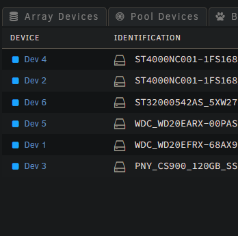

I'm confused. I've built a new USB drive, booted the backup server off of it and transferred the license key to the new stick.
When I look at my unassigned drives, this is what I get:
None of them give me the same thing I saw when I plugged a couple into my main server. None have a "Mount" button (enabled, disabled, or otherwise).
What am I missing here?
Realistically, I could go ahead and rebuild this completely from scratch and I don't think I'd loose much, as far out of date as my last backup was, but I'd like to understand what's going on, first.
You have not installed unassigned devices from apps
I appear to be an id10t today.
TYVM...
