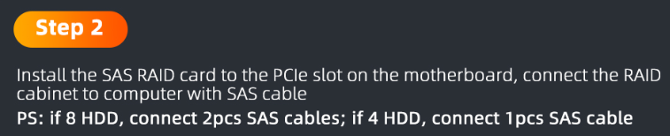

Pls provide the SAS enclosure detail / model.
6 minutes ago, steve1977 said:
For my understanding, this not a true SAS enclosure, it just a cable extension to external box, so that's why connect 8 disks then need 2 SAS cables. All just use SAS socket / cable but nothing relate SAS. ( I may be wrong )
The RAID function just provide by the RAID controller,  nothing relate to enclosure.
BTW, you should see the disks, what disk type in enclosure SATA / SAS ?
I have SATA disks in the enclosure. The enclosure has a display that shows them being identified. I placed them into slots 1, 7 and 8. It also identifies that both cables are connected.
