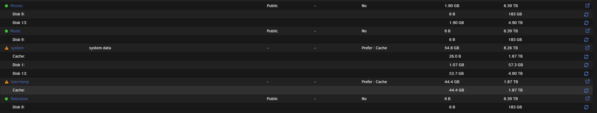

Go to User Shares page, click Compute All button at bottom, wait for complete results, post a screenshot
Well, according to this, there is something in those folders. Why isn't anything visible just looking at the share?

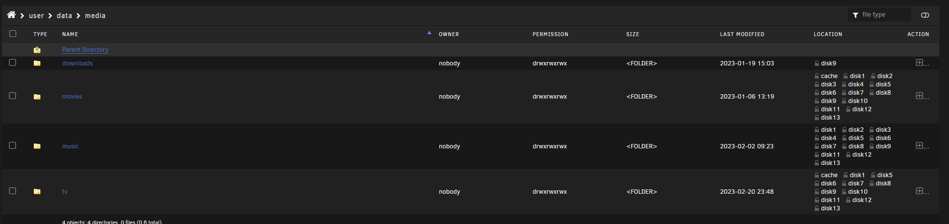

I was told that it was a better idea to put those folders into a different structures so instead of them all being separate at the highest level I created data folder with media within that and then the 3 folders are now all under the media folder. If I remember correctly it was to have the data move less often when being passed between the download, the placing in the proper directory, and the transcoding. Now I'm just trying to remove those original 3 folders.image.thumb.png.ab9ee8b71d3d840a3e4f0342dd806e3d.png
