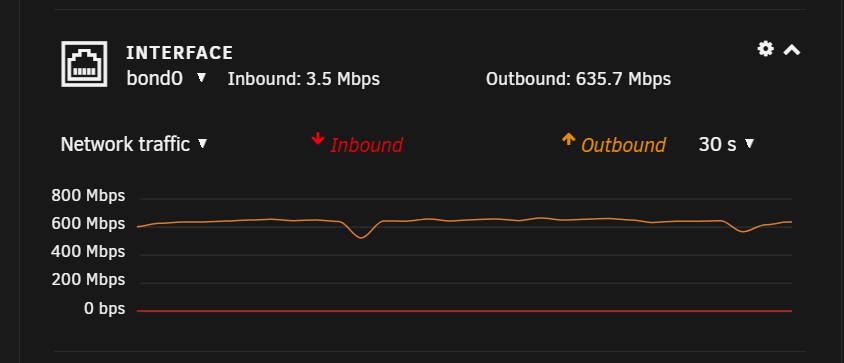

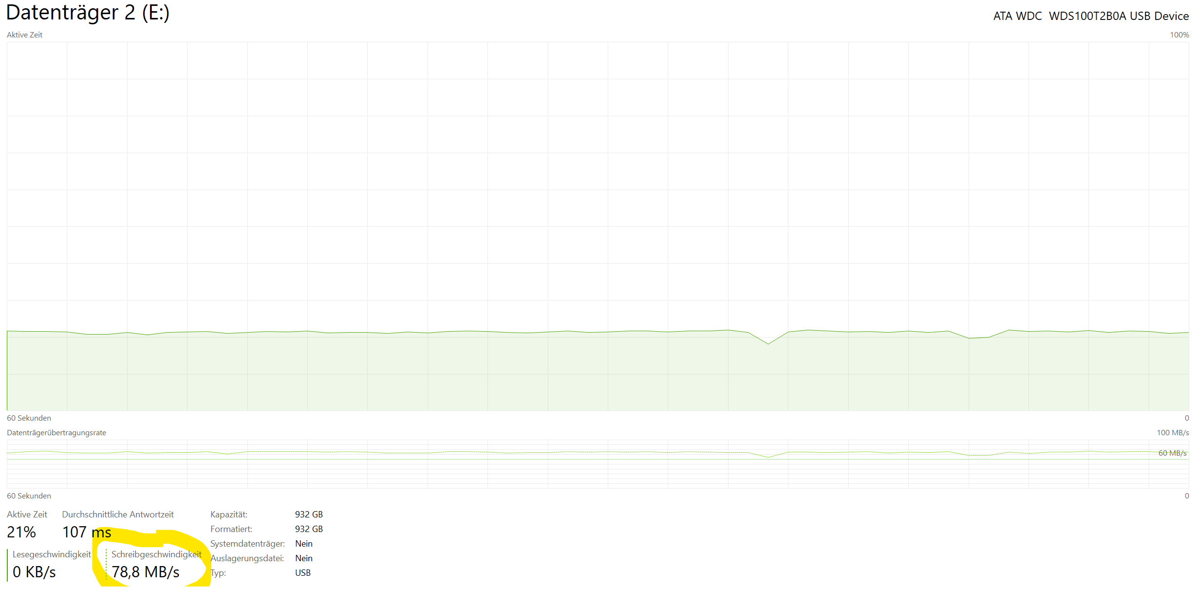

When I upload files from Win11 to my server using SMB I can only reach about 80MB/s no matter if the file is stored on the cache pool (2x WD SN700 NVMEs) or is already on the disk(s).
Sometimes tranfer will drop to below 70MB/s.

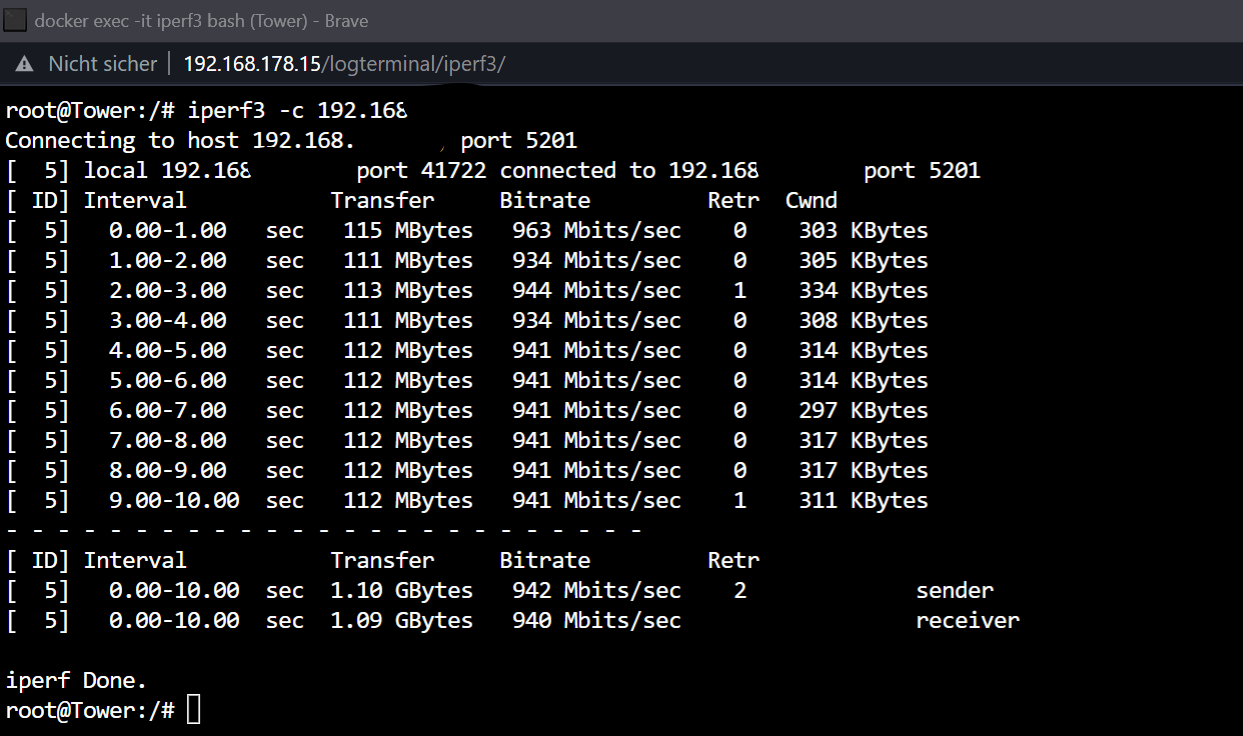

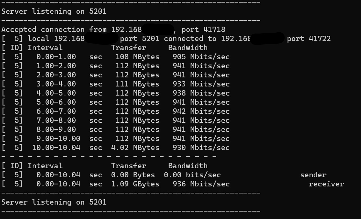

Start by running a single stream iperf test in both directions.
Tests seem to be fine in both directions.
From server to Win11:
From Win11 to server:

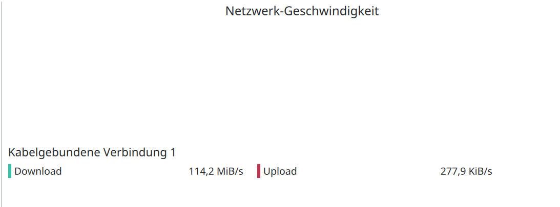

Try with a with a different client computer if available.
Tested with dualboot Manjaro and it looks fine:
1717113177_DeepinBildschirmfoto_Bereichauswhlen_20230228075027.thumb.png.867f444d802368d6ec9aafcafe56046c.png
So it is related to Win11.
