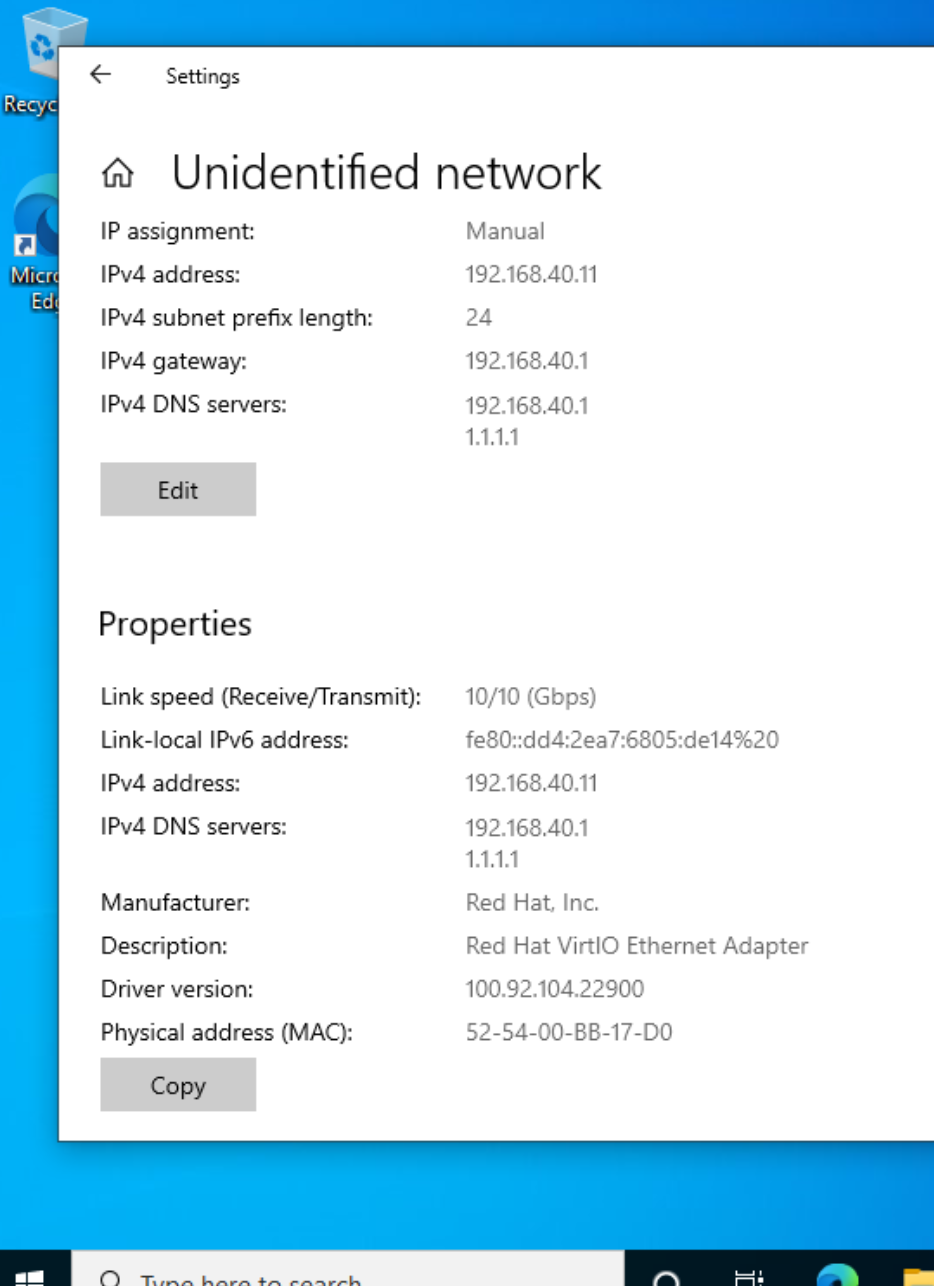

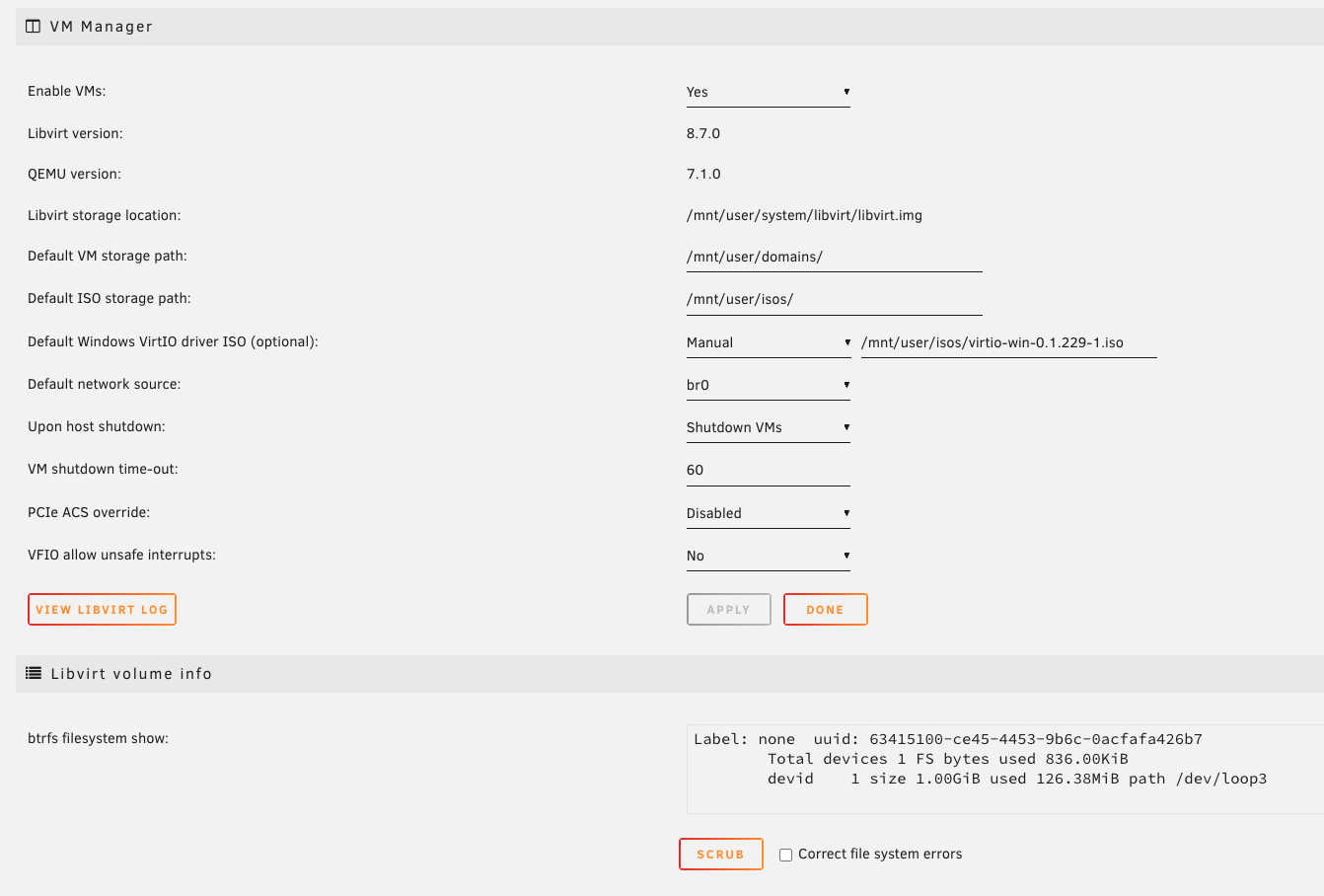

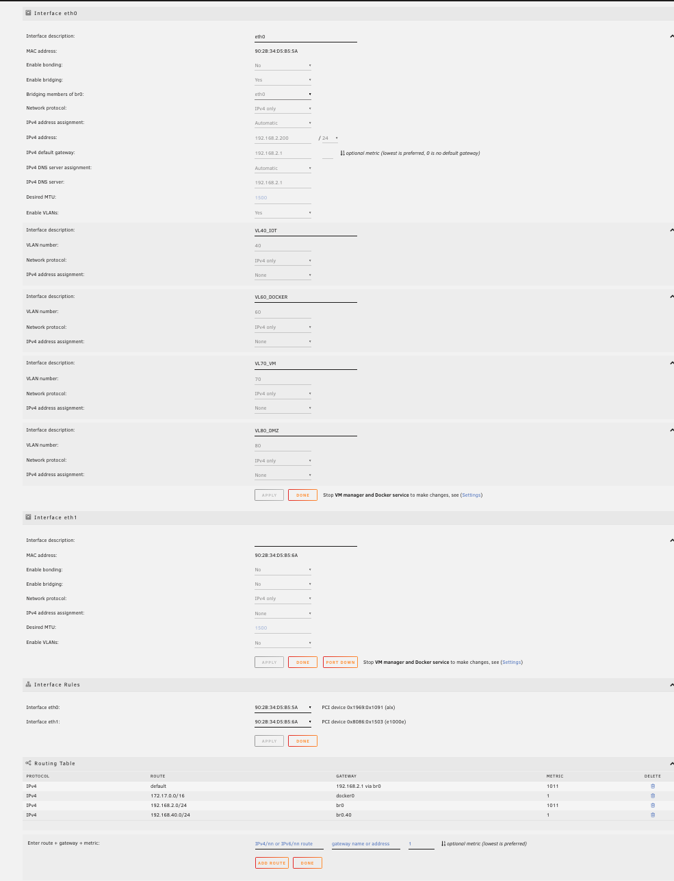

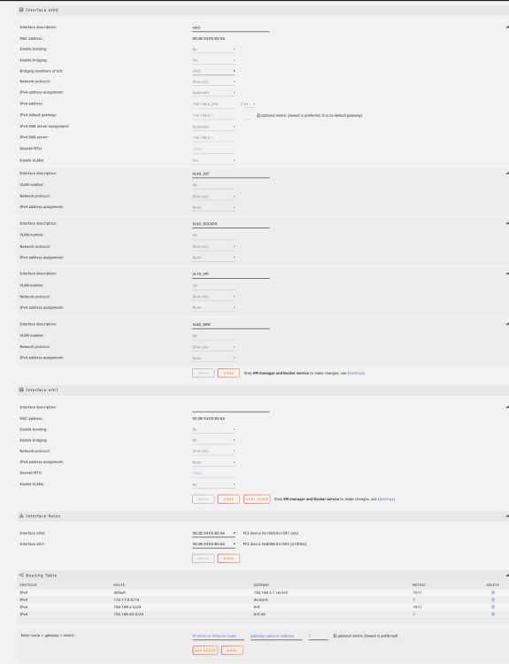

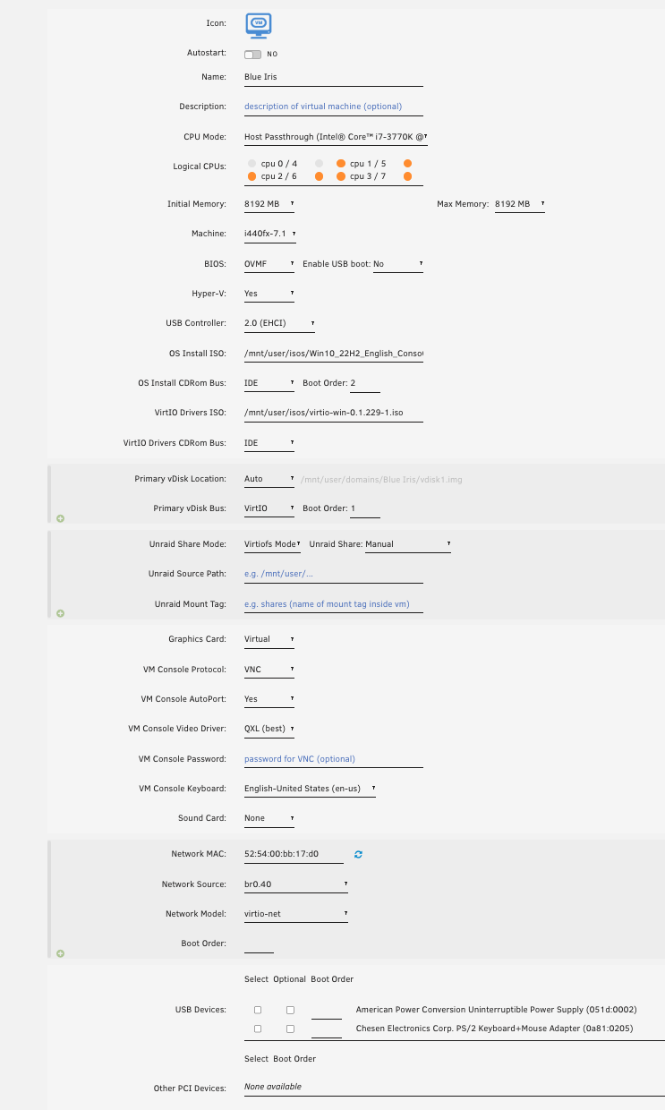

I've have a few vlans setup for use by some docker containers and it all works as expected. However, when I tried to set up a VM on one of those same vlans I can't get it to work. All the setting look ok as far as I can tell but I can't get network connectivity on my win10 vm. Can someone take a look at these configs and tell me what I've done wrong.

What device is providing the gateway on vlan 40?
Problem should due to native Windows network interfaces was untag, but you need make it working with tag 40.
I use pfSense and it was your question that got me to check the vlan config again. I had bound vlan40 to the wrong interface. I switched it to the unRAID interface and all is working now. I was just too focused on the unRAID settings trying to troubleshoot and got tunnel vision. Thanks!
