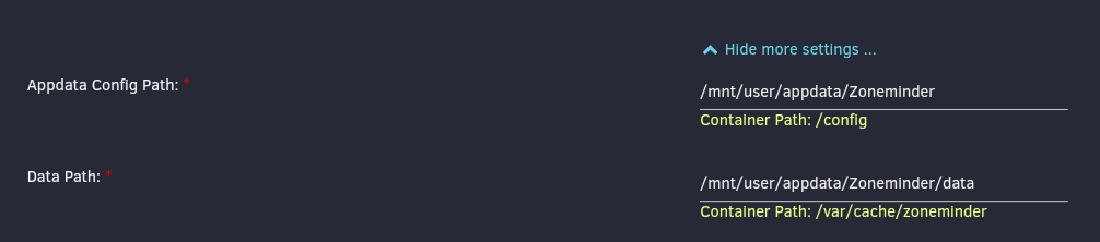

The one here seems to have mount points for config and data that you should be able to map into your appdata
https://github.com/dlandon/zoneminder.machine.learning
As per docs, the mysql and events data is also stored here. The unraid version of image has same mounts (but not same documentation)
If you are using the unraid template provided by CA, it is already mapping to appdata
Edited by apandey
Added template screenshot
