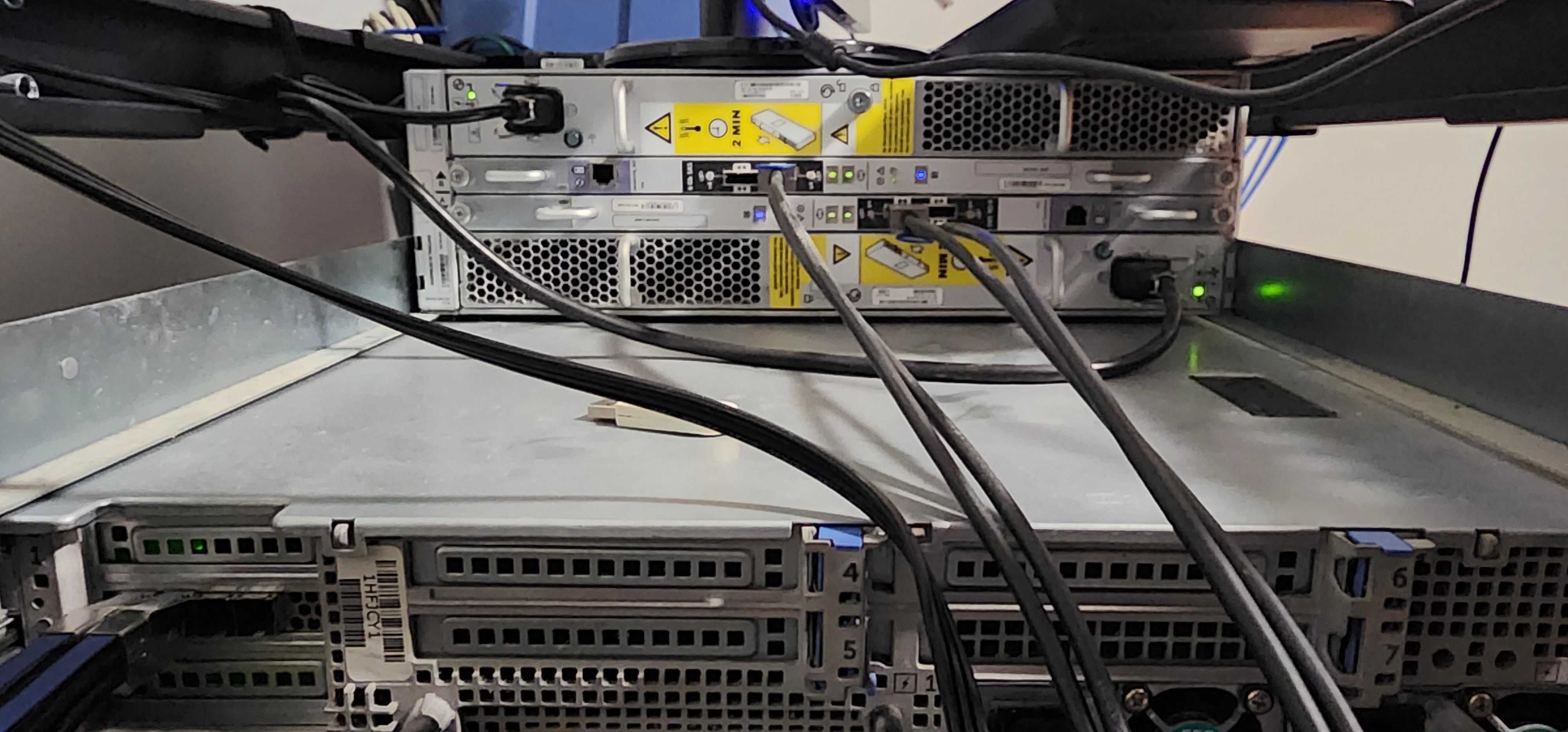

I have 1 cable per controller ( the JBOD has 2 controllers ).  I can try again with only one controller plugged in but I am under the assumption it would not allow all my drives to work.  I will remove one of the remaining cables tonight such that there is only 1 cable from the JBOD to the HBA and post an update.

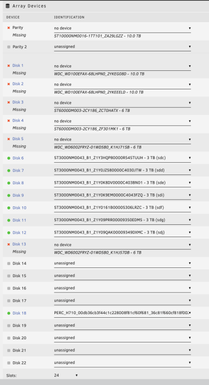

Attached is an image of what happens when I remove one of the remaining two cables.  There is a single cable to each of 2 controllers on my JBOD, disconnecting one makes half the drives inaccessible. Should I plug one controller into the other controller?
Lets start over, you have two LSI controllers and one enclosure correct? There should be a single cable from one HBA to one controller in the enclosure, if you do that and reboot you only see half of the disks?

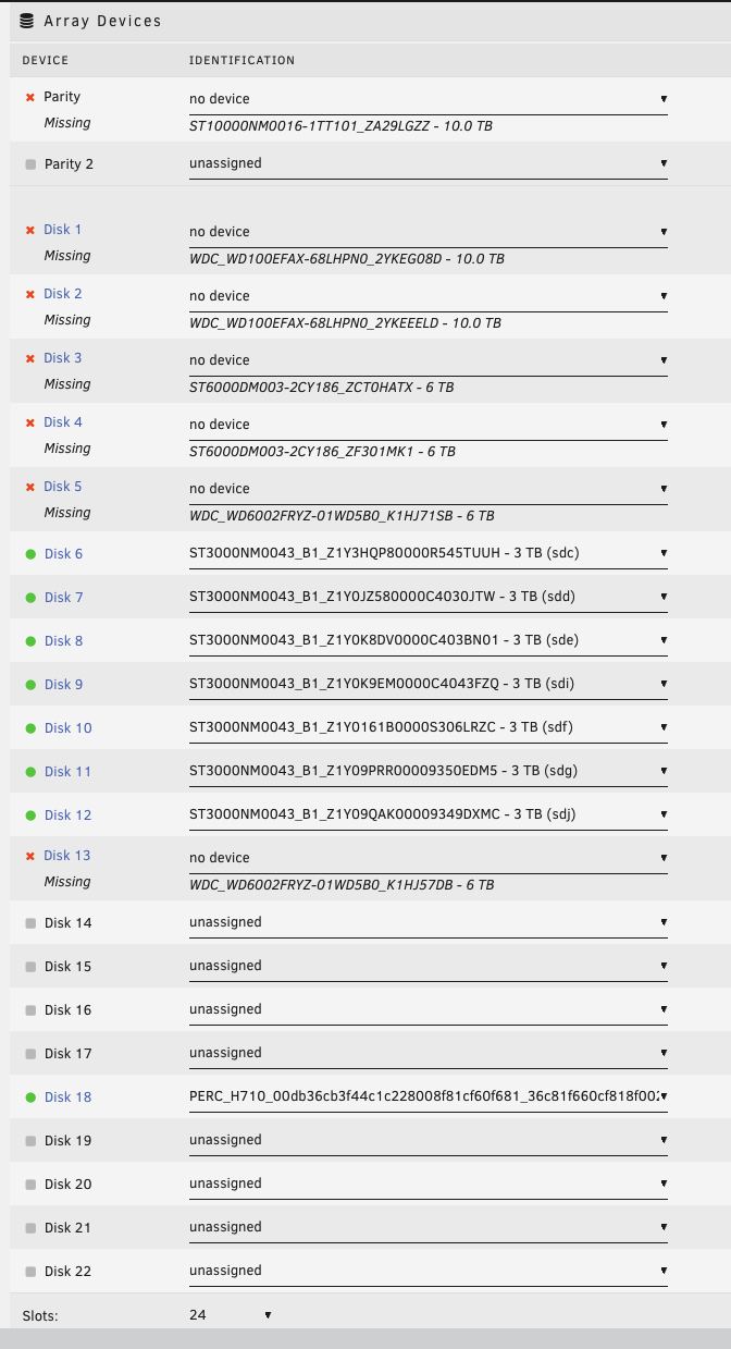

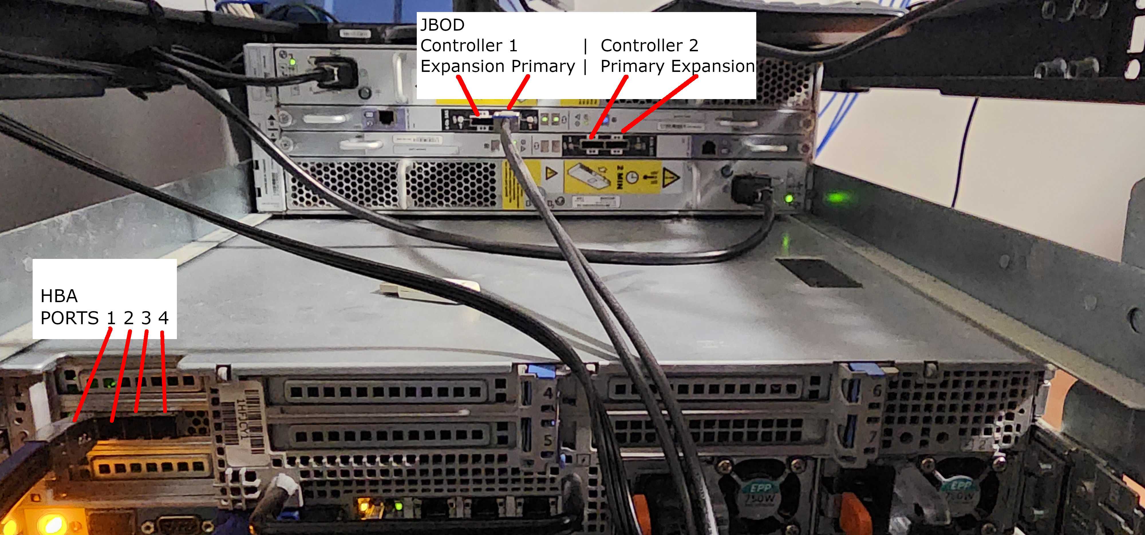

Attached is an image of my setup in its current configuration ( half the drives are missing ).  I have 1x LSI HBA, when I am saying "controller" I mean the JBOD has 2x modules that provide a SAS interface.
The image is how it is configured right now.  I had previously had the following configurations:
configuration 1 ( originally ) : A cable from the primary and expansion port of each JBOD controller/module connected to the HBA, totalling 4 SAS cables from the JBOD to the HBA.
configuration 2 ( when told to remove cables because of SAS multipath ) : A cable from the primary port of each JBOD controller/module connected to the HBA, totalling 2 SAS cables from JBOD to HBA
configuration 3 ( current ) single SAS cable from HBA to JBOD, only half the drives are detected.  As pictured.
Sorry if I have been unclear or I am making this difficult, I do really appreciate your help with this.

OK, and are you sure the 2nd diasgs posted were the correct ones? Something is missing here, since latest diags still show duplicate devices, so it doesn't make send that now devices are missing, can you post new diags with configuration 2?

Here is the new diagnostics, using configuration 2.  Both 'primary' SAS ports from the JBOD are connected to my HBA as per the picture.  it looks like those 'cannot get id' issues are still present.  I restarted the server at 2023-03-07 14:20, the timestamp in the logs confirms that this is the correct diagnostics zip.

Yep, meaning that the disks are being detected twice, I don't know that enclosure but usually multiple controllers are for redundancy, one controller should give access to all the disks, when you tried the single cable did you try it connected to either controller?
I had not tried a single cable with the other controller.  I will attempt to do so.
I do have some manualls and it does show that there is 2 cables but it's not very clear what information it's trying to convey, and only shows controllers linked to eachother.
Yes, looks OK now.

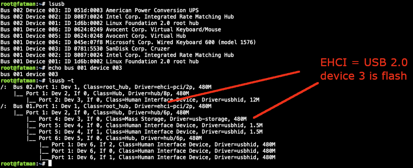

i realized i could check from terminal, here is the result: im pretty sure EHCI is usb 2.0?
Try using the other USB controller.
