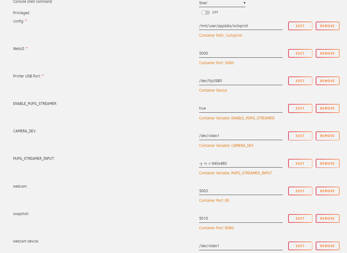

I recently installed the spats octoprint docker and have since tried to add a webcam. I installed the dvb drivers and I see the video0 and video1 in the /dev folder.
I tried both video0 and video1 and when I configure video1, the lights on the webcam turn on. So this seems to be right. When I then try to add the webcam in the octoprint settings with the following URL: http://192.168.1.120:5003/webcam/?action=stream this window pops up however:
with just the png icon in the back. Also when I try to directly enter the URL into the browser I get a 503 Service Unavailable error.

In the docker tab, I force updated the octoprint container (advanced view) to the newest build (that was already installed). This solved the problem and the webcam is now working as intended. Hope this might work for others too
