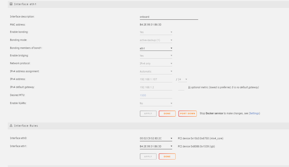

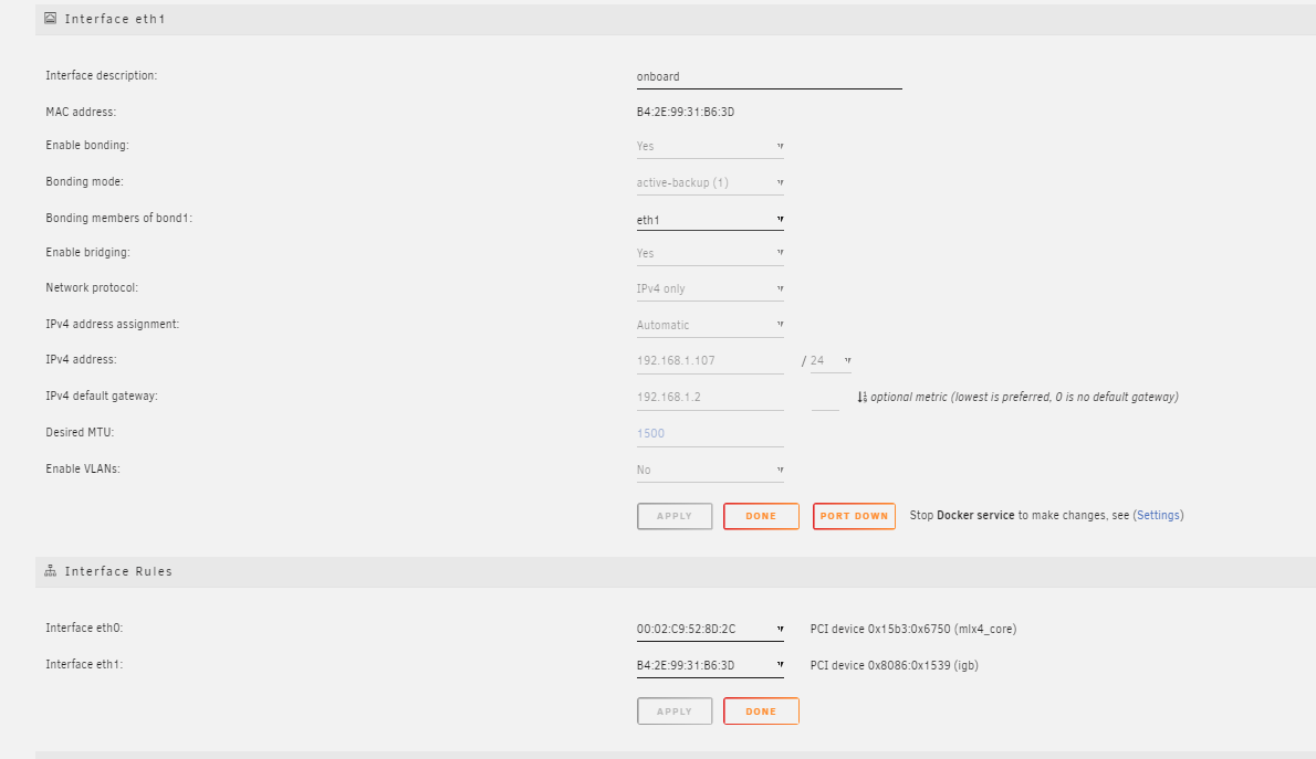

Can someone please look over my network setup since replacing my motherboard/cpu I cannot access it like I used to

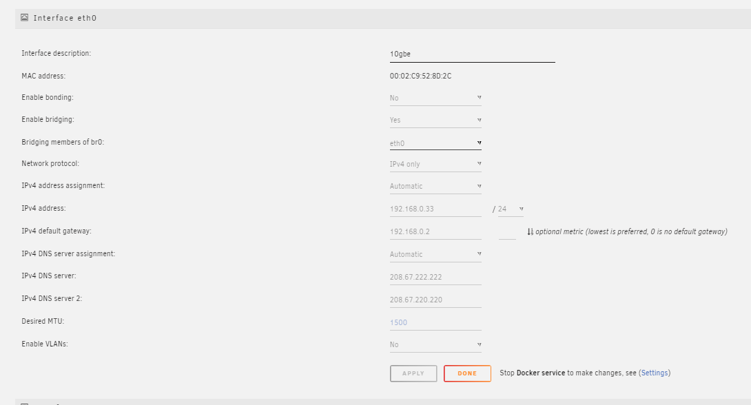

eth0 is 10gbe
eth1 is onboard
I used to just have eth0 10gbe connected for years and it worked fine but since replacing motherboard/network this is no longer the case.
I have deleted the network.cfg file so unraid can create a new one but still this would not work
I have managed to get it "working" by enabling eth1 and plugging in a LAN cable to my switch, although this "works" and I can confirm the 10gbe is also working as I can copy at 900mbp/s to the server from my desktop
My Windows mounts no longer work e.g. \\unraid1\Backups but \\192.168.0.33\Backups works fine.

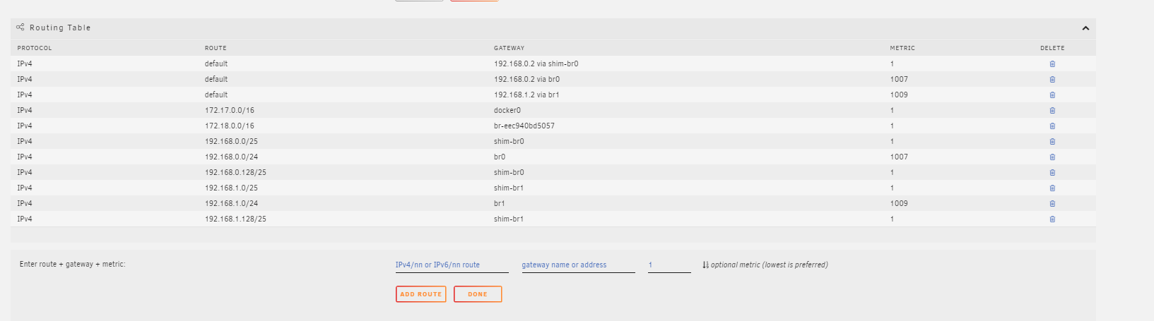

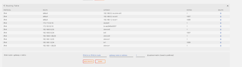

All info in the routing table is automatic, I have not entered anything in there!

Is the 10GbE NIC peer to peer or is it connected to your router with internet access?
Hi JorgeB, it is connected to my router with internet access.

The problem arose after changing the unraid motherboard/cpu so maybe I just made an assumption?  Can you please confirm if my screenshots look ok though?
Thank you
The problem of being unable to SSH arose at the same time as the motherboard/cpu swap as well
