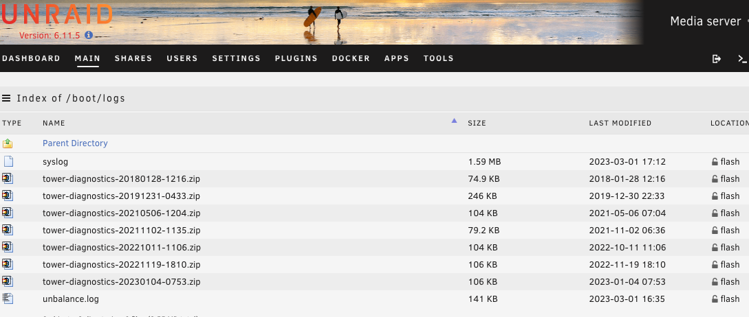

I don't happen to see a pause parity on the main screen, just a "cancel." I can run it for probably 10 hours and be safe to do a clean shutdown, but as it stands now, the server will just crash/shut itself off. Are there any plugins that monitor CPU temp and report in a crash log? Do drive temps get reported in a crash log? I have it set to save the log to the flash drive, but it crashed today at maybe around 10am and I do not see a .zip log right now. Any idea why that would be? I probably do need new hardware, but if it is something basic, I'd rather just repair it.
