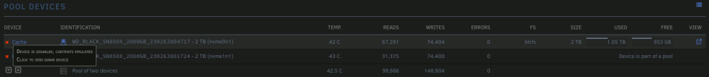

Last weekend I shut down my Docker service, moved all the data off of my 1TB cache array (2 1TB NVMe drives), replaced the drives with 2 new 2TB NVMe drives, spun the array back up, moved the appdata and system shares back to the cache array, reenabled Docker service, and everything was working fine. Today I wanted to add a couple of external USB C NVMe drives. When I added them they wouldn't mount, so I rebooted the server. When the server came back the cache array was indicating that the new 2TB drives were wrong, and it said it was expecting the old 1TB drives still. But the new ones had detected and worked just fine until the reboot. Just for fun I started the array anyway with the new drives in place of the old drives (as they had been working since Sunday) and the cache drive came up and Docker is working and I can write to the cache array, but the cache drives both have a red X by them, and they are both saying they are being emulated. I don't believe that isn't possible, considering there is nothing to emulate them from, and considering my Docker is working just fine at my new NVMe drive speeds.
I mostly wanted to bring it to the forums attention to see if anyone else had experienced this or had any ideas as to why the old drives would have showed back up logically? Everything seems to be working just fine, but I don't really want to leave it like this. Any insight would be appreciated.
Also, I have remote syslog enabled, so if there is anything from syslog that might help I can grab it and share it.

Solved by JorgeB
Stop array, unassign all pool devices, start array, stop array, re-assign all pool devices, start array and you're done.
That worked. Thank you.
