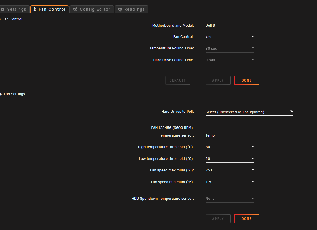

I'm making it complex because it's still very loud despite the reasonable CPU temp of 58 °C. As you can see, the top temp is 80 °C, which should give it plenty of movement to ramp speeds at that point.
It's running at 9600 rpm, which is a bit too loud at that temp, IMO. So, I'm just hoping to be able to make tweaks to it. If not, no worries, it's still WAY better than without.
when below your minimum temp setting, the fans run at the fan speed minimum.
once it hits above your minimum temperature, it starts applying the curve between your fan speed minimum and fan speed maximum depending on your temps
for the settings you posted, your fan logic would be:
-run the fans at 1.5% until the CPU hits 20 degrees.
-between 20 degrees and 80 degrees, apply and set the fan speed/curve between 1.5% and 75% depending on where the temperature sits between 20 and 80.
-any temp past 80, run the fans at 75% (the "fan speed maximum")
these are bad settings because your CPU will never run below 20 degrees.
my CPU idles in the mid-40 degree range, so I have my low temperature threshold set to 50, so the fans don't bounce around with minor temp changes at idle. it doesn't start applying the curve until it hits 50 degrees (my low temperature threshold), which means the CPU is actually doing something, so it starts ramping the fans up (at 50 degrees)
very nicely put.
This is amazing and makes so much sense!! Thank you!

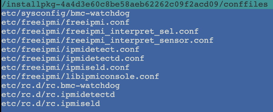

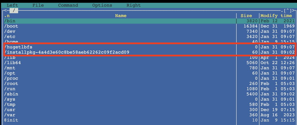

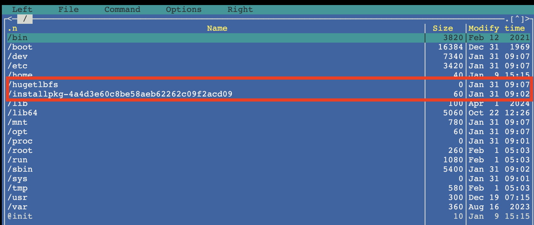

Question: I applied the new unRAID Patch plugin yesterday and had to reboot due to the mover issue - uninstalling the mover tuning plugin still didn't let the mover fix get applied. After the reboot things are operating normally, but today I opened a terminal session and saw something that I haven't seen previously.
The 1st screenshot below shows two folders that I've never seen before when at the root of the unRAID filesystem. The installpkg one contains a file named conffiles which appears to be a leftover from installation of the IPMI plugin. That file is viewable as raw text and contains the data in the 2nd screenshot which led me to believe it's related to the IPMI plugin.  Is this normal or just a one-off? Is it safe to delete? It doesn't appear to be affecting anything operationally and I didn't find anything in syslog that references it.
The 2nd folder is the empty one called hugetlbfs, which may be unrelated to the IPMI plugin but is new to me. I'm not seeing any operational changes or lockups, but my OCD always has me investigate things even if they aren't or don't appear to be affecting normal operation. This one may be related to using the command 'touch /boot/config/fastusr', used to make unRAID load all modules into RAM rather than having fallback to some on the USB key. Thoughts?
Thanks, Will look into my Slack build script I compiled a new freeimpi package looks like that path should be excluded from the package.

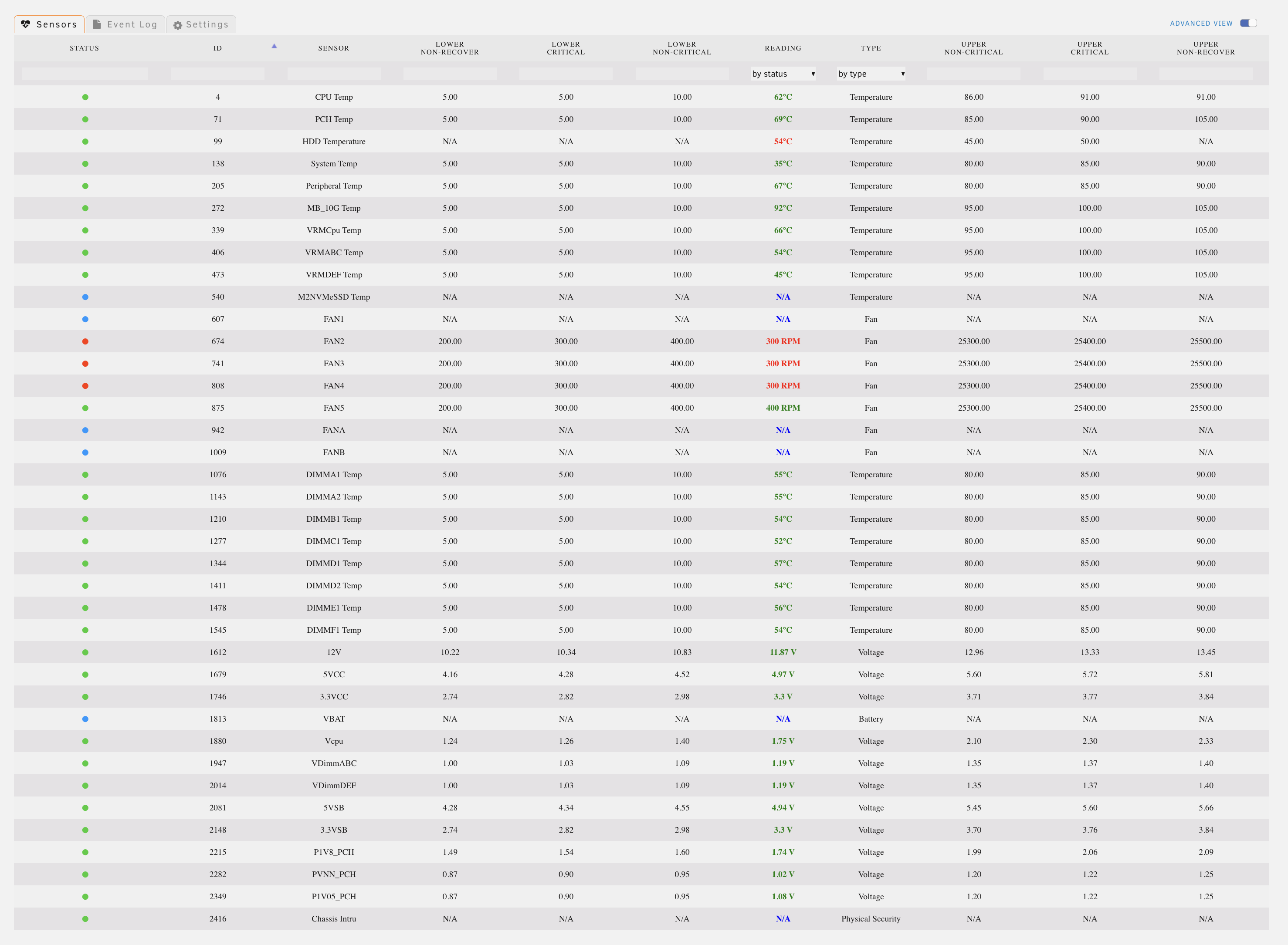

Hello, little update from my issue with IPMI plugin
I find out the polling Temp stop when there a Critical issue in the Event Logs and after I cleared the warning, it doesnt restart...
and for unknown reason, there 1 sometime 2 fans been detected at 0 RPM. and After after that. it show weird warning like when the RPM are around 1 200 RPM even if the Lower CT is set at 200 or 300 rpm, it appear in the Event Log.
I disabled the  HDD Spundown option to test if is that option who put my fan to 0 RPM while switching to another sensor.
I got one question -> How do I restart the polling temp? it seem stuck at the last configuration showed in the ipmifan.log and no update appear in this log since the Critical Warning.
Thanks
Thanks

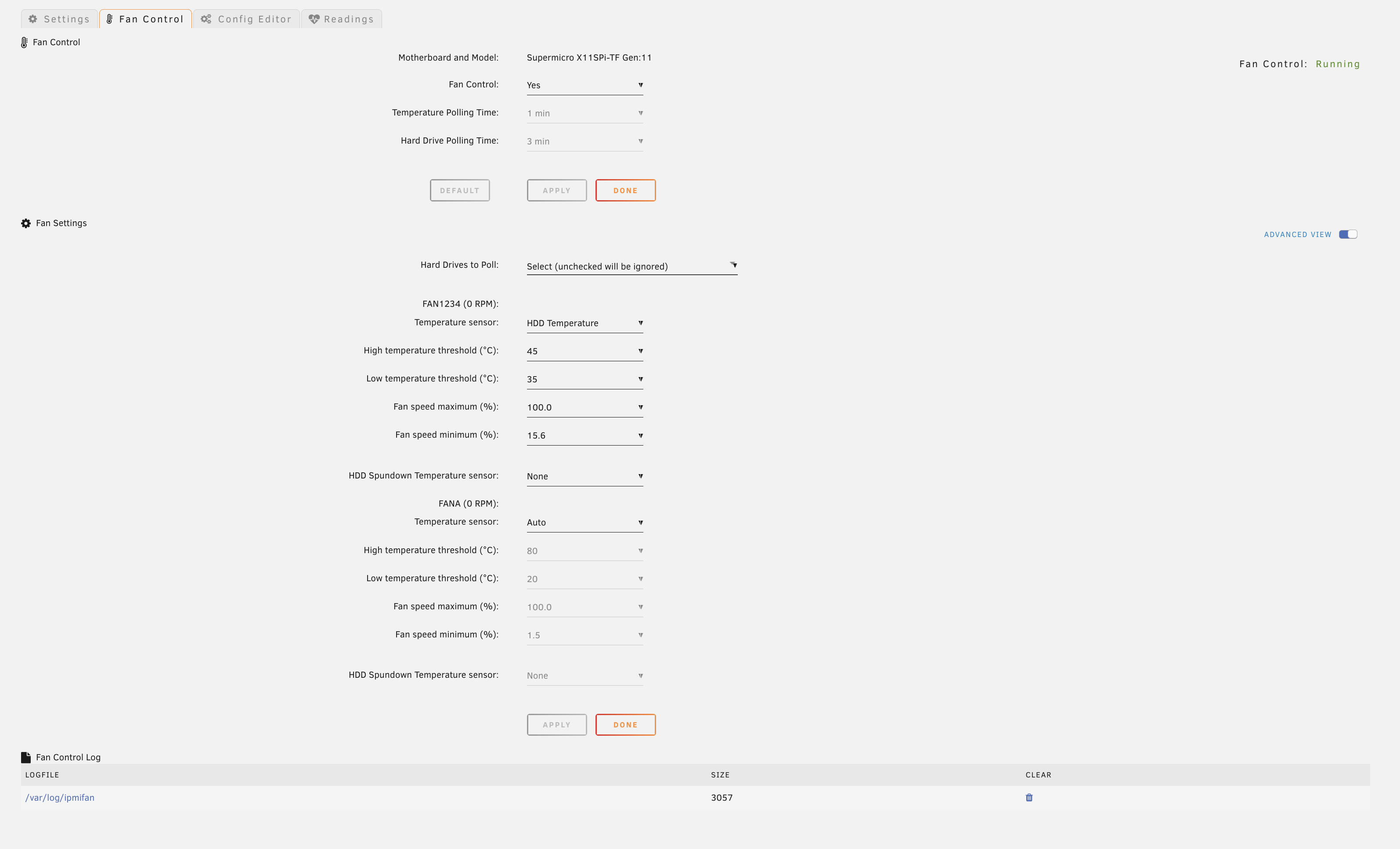

post your fan settings page screenshot
There the Screenshot
I got 3 fans stuck between 6 800rpm  and 7 2000rpm
Edited by FTW
after few test. I unplug my FAN5 and FAN6 and did a "ipmitool bmc reset cold". They are the one who hitting a lower critical NR and I fall on another issue... this time its FAN ABC who are stuck at 7200rpm while FAN 1234 are at normal RPM....
on supermicro boards, fanA is for the CPU and FAN1234 is chassis fans.
looking at your manual, your board has FANABC and FAN123456. so it looks like the plugin is not taking all your headers into account.
you could put both CPU's on FANA via a splitter and use splitters to keep your chassis fans on FAN1234 only.
or see if @SimonFcan add support for the additional fan headers
Edited by spl147

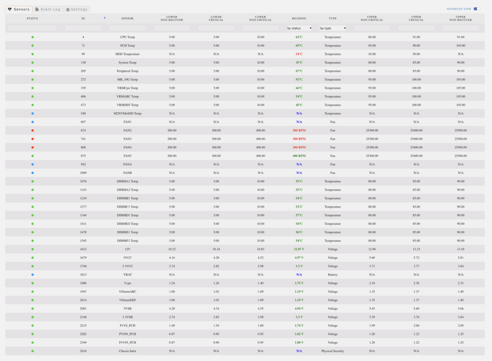

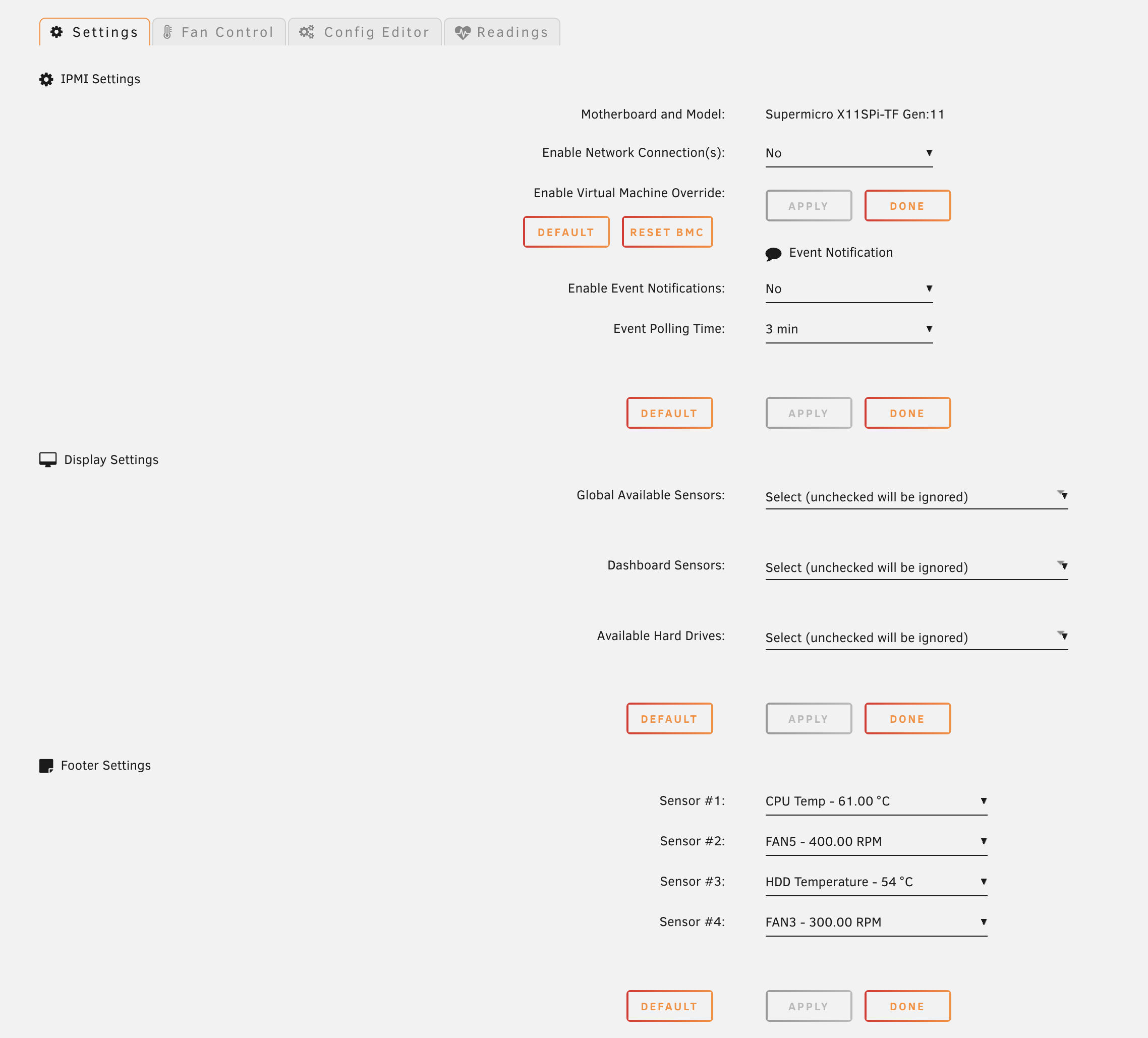

@SimonF I have the exact same issue. Using an Supermicro X11SPi-TF , Version 1.02 motherboard. Here's my fan settings page (let me know if I can post any other diagnostics to help locate the issue):
36 minutes ago, jch said:
A
Thats the sensor page not the fan setting page
Is this it?
13 minutes ago, jch said:
Is this it?
No, click the fan control tab
3rd time's the charm.
21 hours ago, jch said:
A
I will release an update with a new package over the weekend as no longer get the directory but just want to tidy up a message that apears on the console. Hugetlbfs is for hugepages used by VMs etc.
Package has been updated. But may need a reboot to replace.
