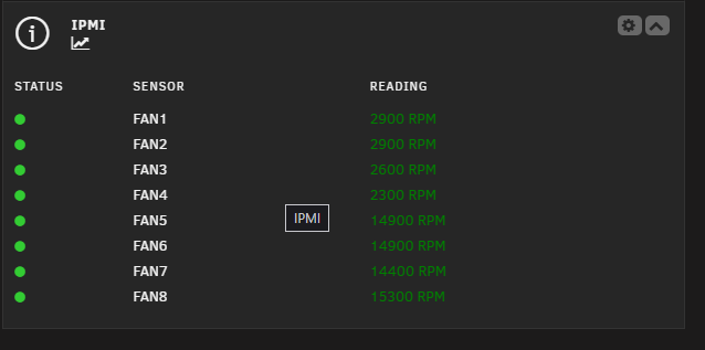

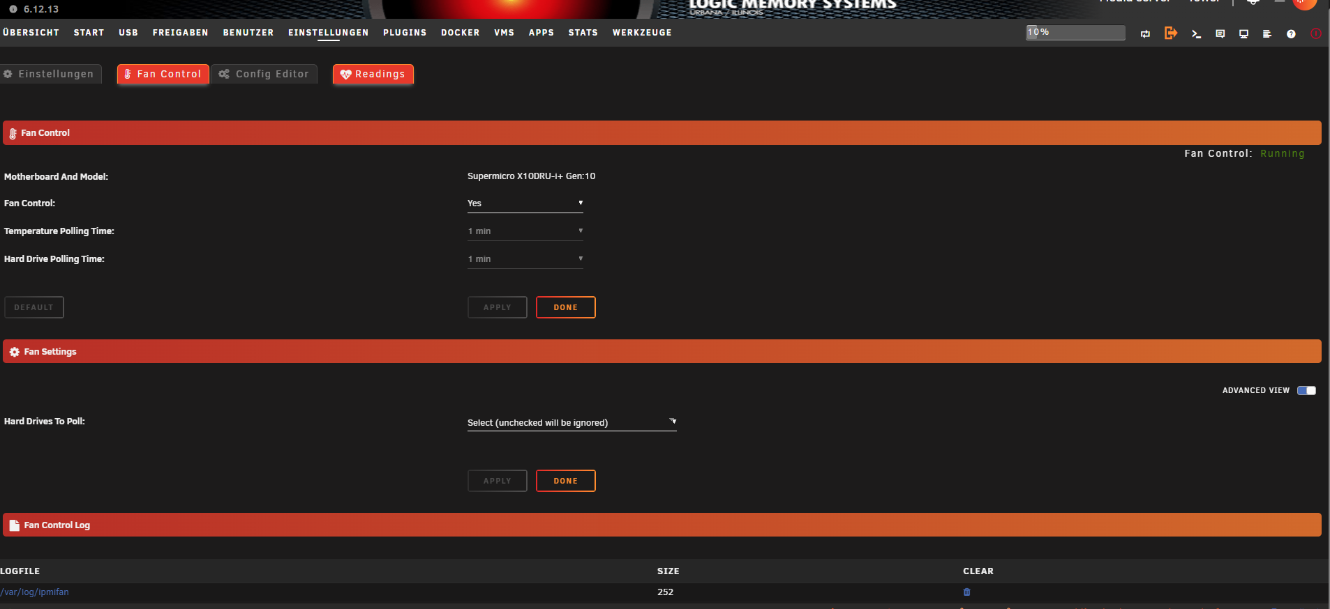

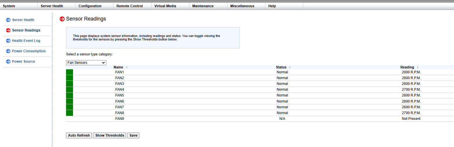

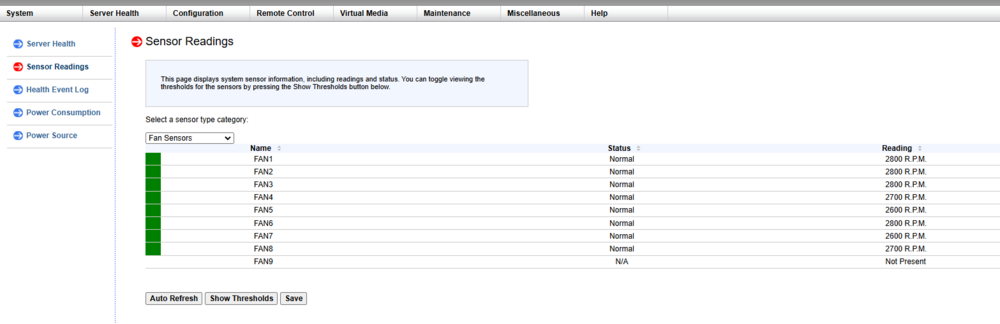

I have a problem. Unfortunately, only 4 out of 8 fans can be controlled. See the picture. Can someone help me? I'm pretty new to this.
With this script, I can control all fans, but it's unfortunately inconvenient.

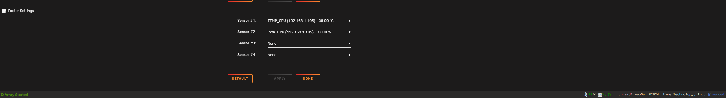

from this pic, you have not setup fan settings, so ipmi has no idea how or what to control!
also this has been covered multiple times. only the first 4 fans are controlled. use splitters
Edited by spl147

fan splitter (run multiple fans off 1 header)
these settings:

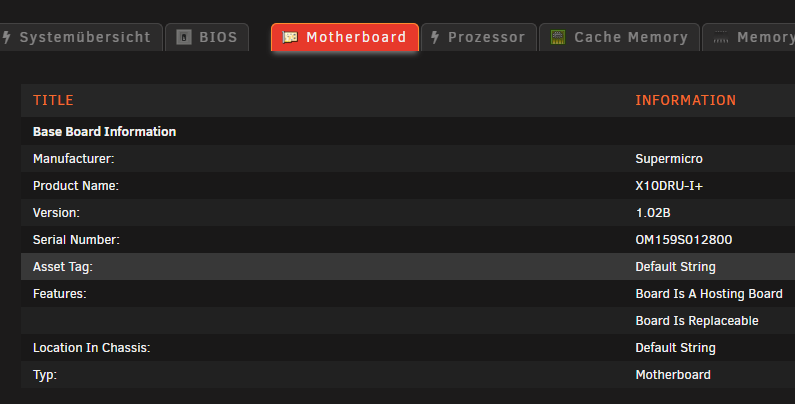

ok with the unraid version I couldn't control anything from the fan, maybe it's related to my board
Supermicro X10DRU-i+ Gen:10
in the settings tab you have network connections set to no correct?
yes cannot be changed either
stop fan control to make changes.
I have but unfortunately I have no access to the IPMI because I bought the server used
Edited by Denis06061986
WHAT? what does that have to do with it? you mean the bios? stop the ipmi plugin to make changes to the plugin.
you my friend need to do some reading!
sorry my English isn't exactly the best
I've just managed to get my IBMI access
I then entered the data and now it seems to be working

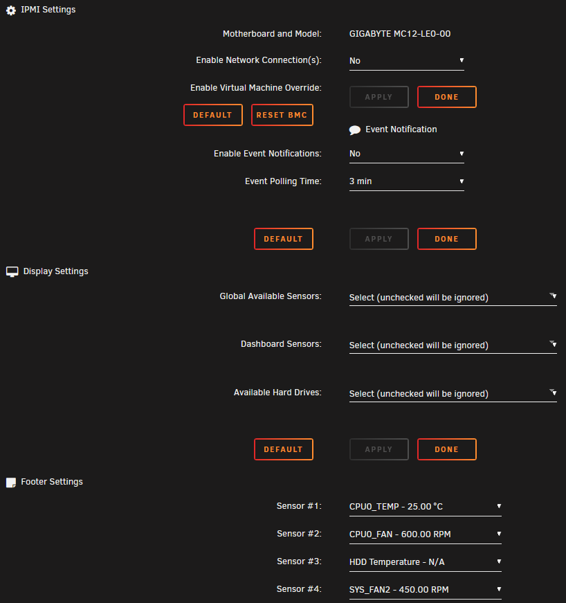

Hey there,
Unraid 7.0.1 - on a Gigabyte MC12-LE0, I can't seem to make the Fan Control tab to show up in the settings, neither with Network Connection setting disabled or enabled.
Sensors under Display Settings show up as expected and I can set them up to be displayed in the footer.
What am I missing?
1 hour ago, icezolation said:
Hey there,
What am I missing?
Your board is not supported
