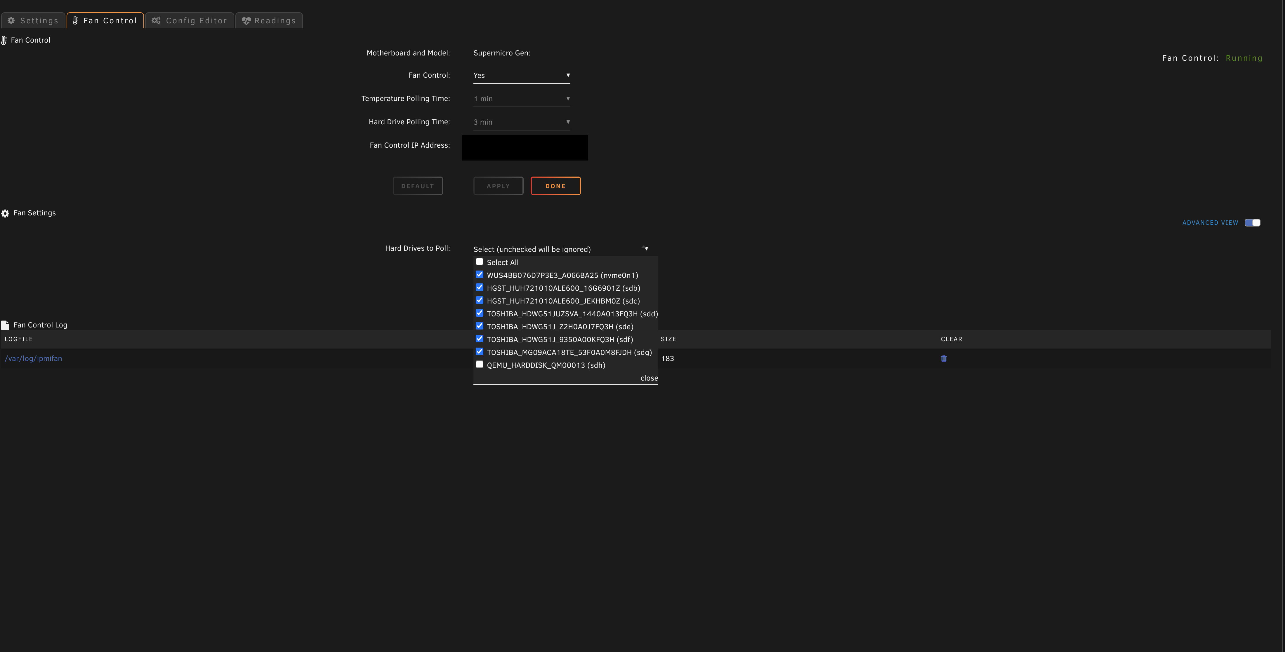

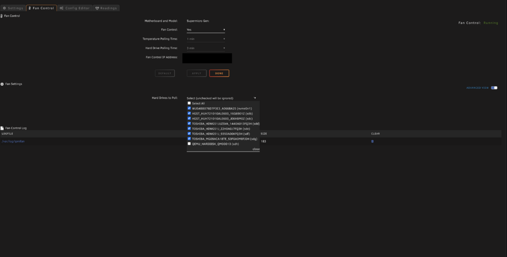

First, thank you for supporting this great plugin. I apologize if this question has already been asked and answered.
I have a Supermicro X10SRI-F. I have successfully connected the IPMI Tools plugin to the board's IPMI. I have enabled fan control. However, I do not see any fan control settings. I have tried changing the board's fan modes (standard, full, optimal). Do I need to restart my machine for the settings to show back up? My fans are Arctic P12s.
My goal is to use the fan control settings to change fan speeds based on sensors temp readings of HDDs and CPU separately.
Thanks in advance for your support!
Please post a screenshot of that page, pretty sure I have one of those boards at home and it works.

16 minutes ago, marionza said:
Here you go:
Click on fan control tab. Fan control needs to be stopped to make changes. Is fan control blank? Also changed to advance to FC page.
Just the Fan Settings section is blank. Advanced is enabled. IPMI fan mode set to optimal, but I've also tried standard and full.

3 hours ago, marionza said:
Here you go:
Try removing the network connection and Virtual machine override as should not be needed. Can you provide the sensors page output also.
After removing the network connection, the Fan Settings section under Fan Control returned. However, I am not able (or cannot figure out) how to disable the Virtual Machine Override. For now, I have it set to Supermicro X10 as my board is an X10SRI-F.
As I'm sure you're aware, I had to set Fan Control to No to be able to remove the network connection. Before I set Fan Control back to Yes, All of the fans would spin down and then up continuously. This behavior stopped after I set Fan Control to Yes. With Fan Control set to Yes, all of the fans' speeds seem to be pinned. FANA cools my CPU and FAN1-5 cool my HDD array drives. Here's what that looks like on the Sensors page.
Here are my Fan Settings.
Here are the sensor settings for all my fans.

Is there any configuration I need to make to control my fans on Supermicro H12SSL? as enabling Fan control doesn't do any changes?Screenshot2025-04-16at16_37_56.thumb.png.9ec124597007f0f3ddd3aa7e040e2b0d.png
Edited by noonamer
screenshot
I think I have figured out, it was a "too long password" now I can see 2 groups of fans, but ideally I need 3. and it does not seem to be able to change fan values
