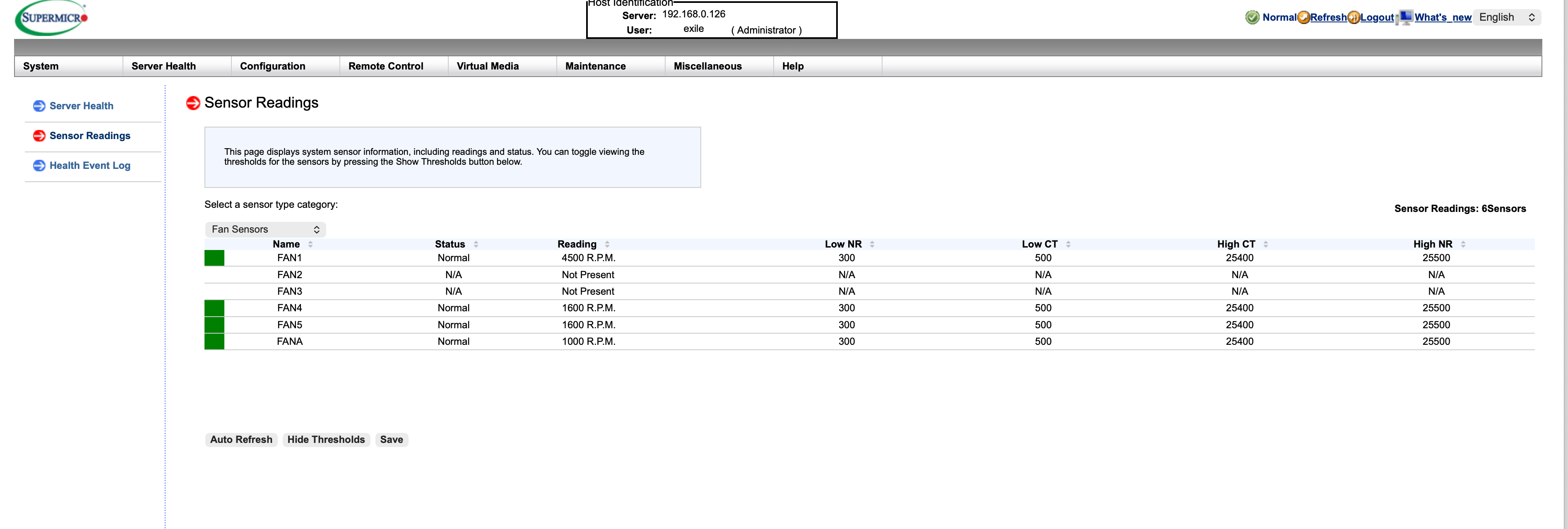

My Supermicro A1SAi hasn't worked since I updated unraid to 7. I am able to see my sensors:
But no Fan Settings appear:
My Sensors config shows the 2 fans, but I am not sure if this is a holdover from previous settings.

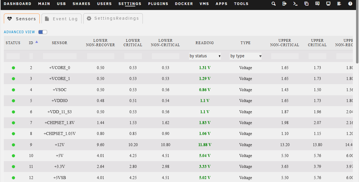

Servus, I've just updated to Unraid 7.2.0 and noticed that the settings page looks strange. It needs to be tweaked a bit.

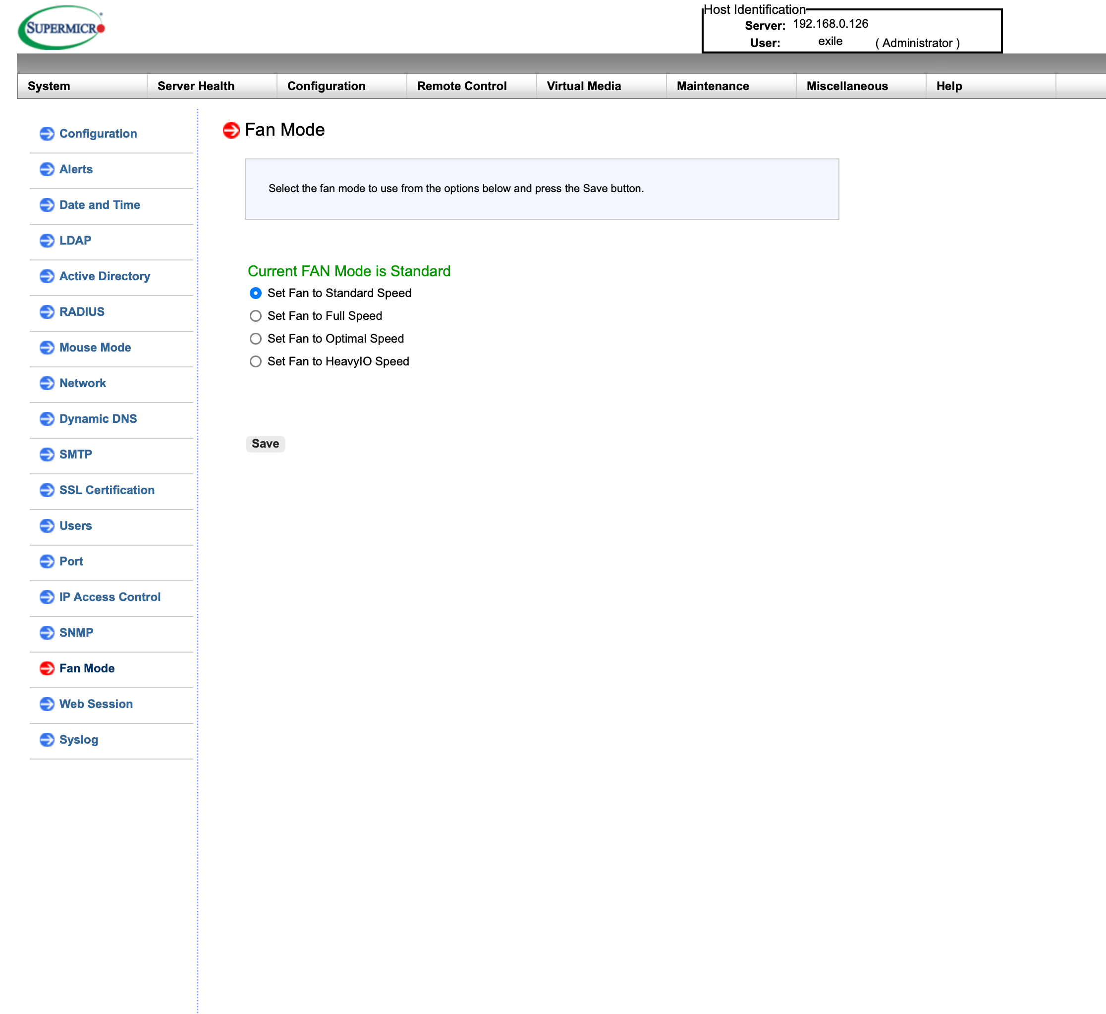

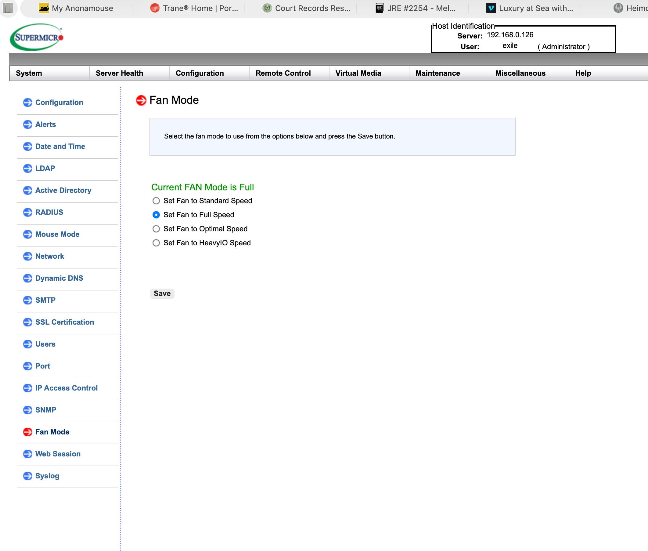

IPMI plugin forcing my Supermicro FAN Mode to Full Speed
What am I doing wrong here? In my Supermicro BMC settings I have my FAN Mode setup at "Standard Speed" and as soon as the Unraid boots I think the IPMI setting overwrites the fan mode settings from standard to "Full Speed" which will crank up the fans at max speed. I see no settings in the IPMI plugin for the Fan Mode. I really need to stay at Standard Speed. Any ideas?
Do you have fan control enabled in the plugin? IIRC, when that's enabled, it will always set them to full speed before starting to control them based on the settings.
Yes Jorge I do. So it looks like I have to play with the thresholds in the IPMI plugging fan settings as I think they're to aggressive.
