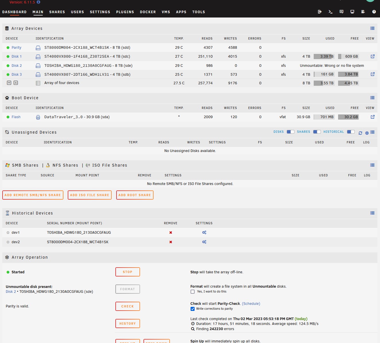

It's back again?! "Unmountable: Wrong or no file system"
So thanks to Jorge last week, I got myself sorted, but i rebooted my server (unplanned) and it's now showing the same issue with the Unmountable disk again.
Anyone have a clue how i get it back online without formatting it this time? FYI the Bios is 100% on SATA not IDE.

"unmountable and disabled" - Note: If a disk is showing as both unmountable and disabled (has a red 'x' against in in the GUI) then the check/repair process can be carried out on the disk that is being ‘emulated’ by Unraid prior to carrying out any rebuild process.
This isn't my issue. It's mounted by says incorrect file system.
It is NOT mounted - or it would not be showing as unmountable according to your screenshot.   The drive has not, however, been disabled.
Running just the check is a read-only operation so it will not change anything and the output from that gives an indication of what the state of the disk actually is.
