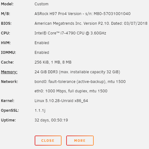

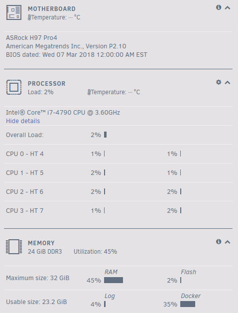

My Unraid box is a hodge-podge of previously loved consumer hardware which is totally fine for my needs, runs about 25 dockers and gives me 49GB of usable NAS space on top of Unraid 6.9.2 with one SSD cache drive (docker + VMs) and one SSD unassigned device (dumping ground for downloads) (screenshots below).

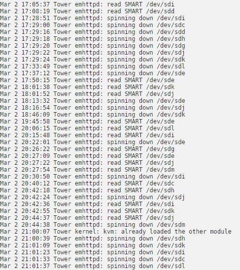

Everything has been working more or less perfectly for a long time (aside from the silly SMART wakeups that I've never been able to find a solution to other than "it's fixed in 6.10+).  Everything is in xfs.
