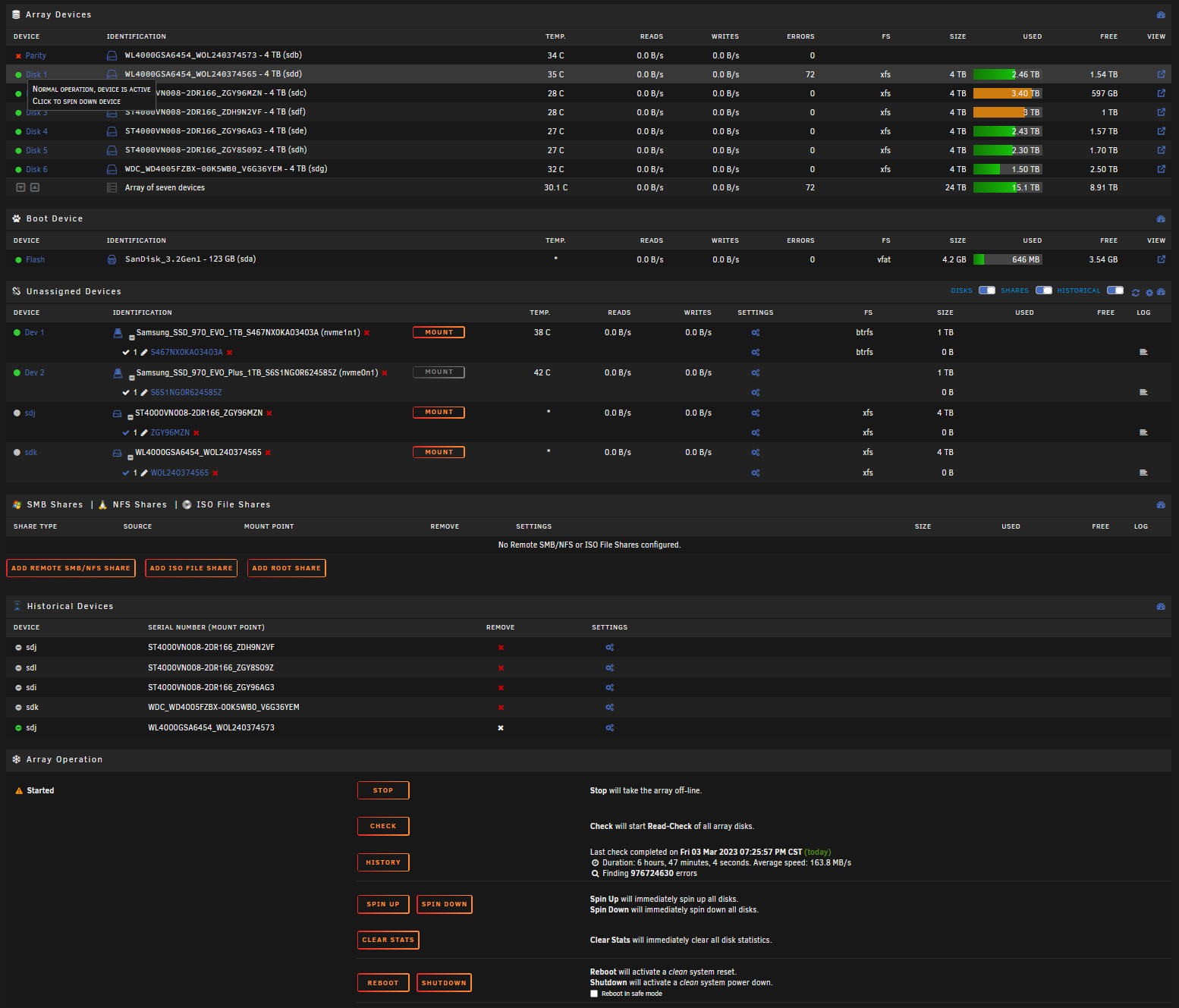

I have some weird happening with my array. I will try and describe the series of events the best I can.

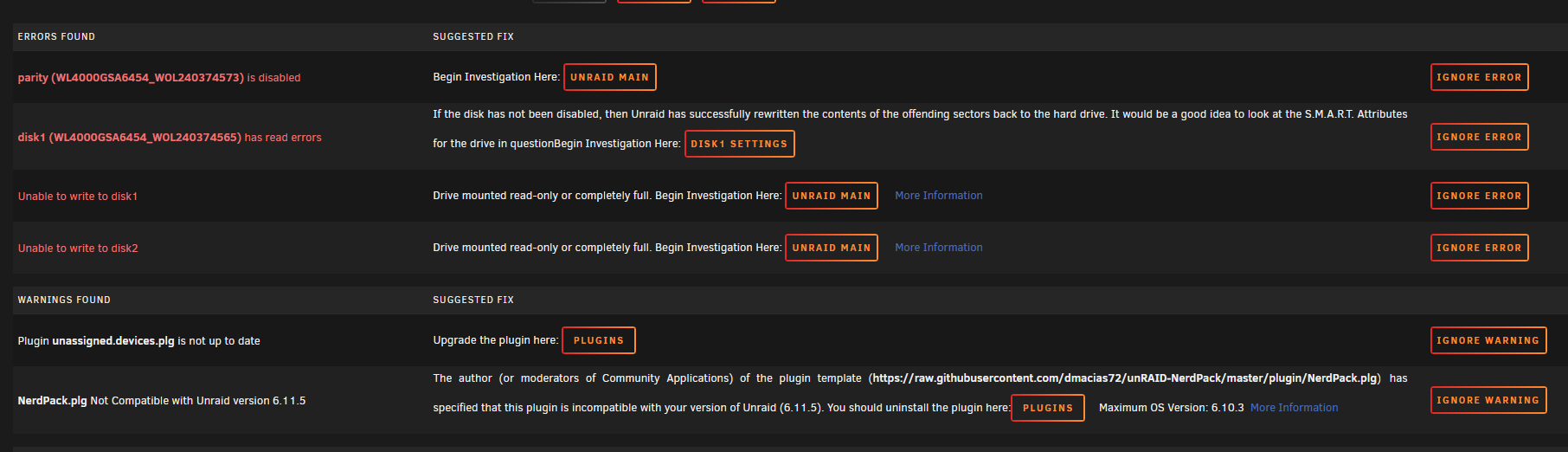

TL;DR I tried to bring my disk1 online. It and parity disk took turns being offline. After 3 or 4 parity syncs and disk rebuilds. Parity disk will not go online after parity sync. Unraid has multiple notices saying Disk1 Disk2 can't be written to. Disk1 has read errors. Parity disk is disabled.
Before I began my upgrade I have 7 disks total with 1 being parity. I have 1 cache drive NVME.
I had planned to install a 2nd cache drive and assign it to the same pool.
I install the 2nd cache drive. On bootup it asks me to assign it BTRFS. I click yes and that brings my 1st cache drive offline because it was formatted XFS. At the same time my Disk1 showed it was offline. I restarted Unraid multiple times and tried different cables and SATA ports. I though the disk being offline meant that it was not recognized by the OS/BIOS. I learn that was not the case and that the disk had to be rebuilt by the parity data. I take the array offline remove the disk, start the array, stop the array, add the disk back. Rebuild begins. After rebuild unraid says all disks + parity are online. I remove the 2nd cache slot and set the cache pool back to XFS and assign my cache drive back to the pool. I move the data off the cache drive by invoking mover and setting all of my "prefer cache" disks to "yes cache". All the data moves successfully. I also as a precaution copy the appdata folder contents to my main PC via SMB.
I notice that my VM list and Docker list are empty. I restart unraid. I should mention at this point and before during the restarts Unraid was not able to properly shut down. It would either hang on trying to stop the array, and do absolutely nothing for 30 minutes or more. Or it would spit out on the local console that it had IO errors. I didn't think anything of it. 3 times now upon boot up my computer would not recognize any bootable devices including the unraid USB except for the 2nd cache drive which had a windows install. After a restart unraid would boot.
After actually booting into unraid if I had rebuilt disk1, the parity disk would be offline and I would take the array down and back up to get it to parity sync. If I had previously done a parity sync before a restart disk1 would be offline and I would take the array offline and back online to rebuild it. Now after each restart and parity sync, the parity disk remains offline even before the restart and the "successful" parity sync. Also as of now there is no longer a parity sync button, it has been replaced with a read-check button.

I have attached some diagnostic dumps and here are screenshots of my current webui. I also have a flash backup of unraid from 02-15-2023 I believe it is version 6.9.5 in that backup?

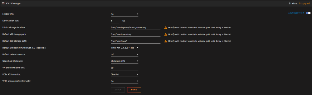

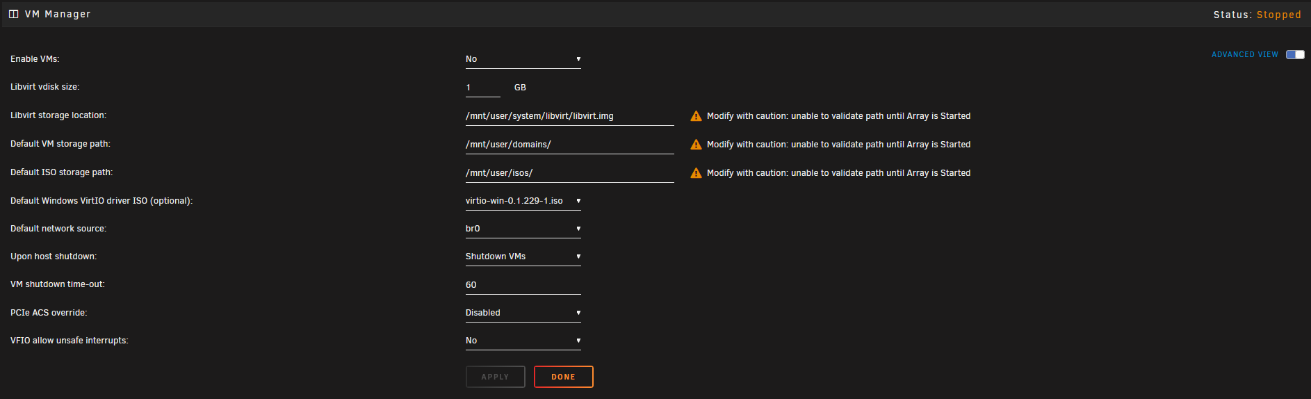

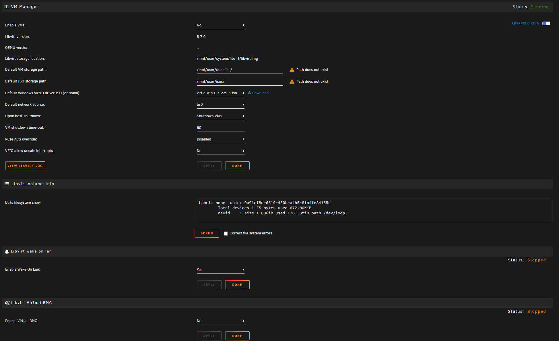

I have tried to disable the VM manager. It still says running in the top right. But the VMs tab is gone and enable VMs is set to 'no'. Unraid did hang on the loading icon for a few minutes. I refreshed the page to regain control of the webui.
How should I go about removing the libvirt.img file? I assume I would see a button next to the path location in the settings page.

The service must be stopped for the delete option to appear, edit /boot/config/domain.cfg and change SERVICE="enable" to "disable" then reboot.
Looks like the file was properly modified by the webui. But unraid failed to properly shut down the VM service. After a restart I can now modify the Libvirt storage location path. Do I need the array running to see the option to delete libvirt.img?
If the SATA controller passthrough was the culprit, with the VM manager disabled in theory I should be able to start the array and repair it without issue correct? Even with out removing libvirt.img?

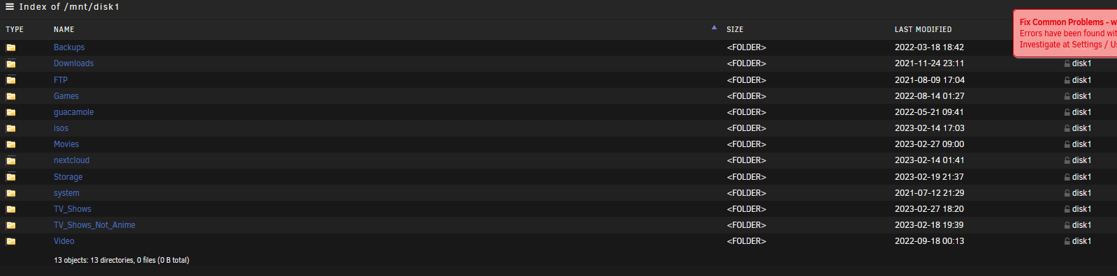

There is also one more thing I want to point out. Currently on my Disk1 if I look at the contents of the disk I do not have my usual SMB shares. Instead I see a linux file system. If I navigate to /mnt/ I can see Disk2,Disk3,Disk4, etc but no Disk1. Just want to put this info out there before any more rebuilds or parity checks are performed.

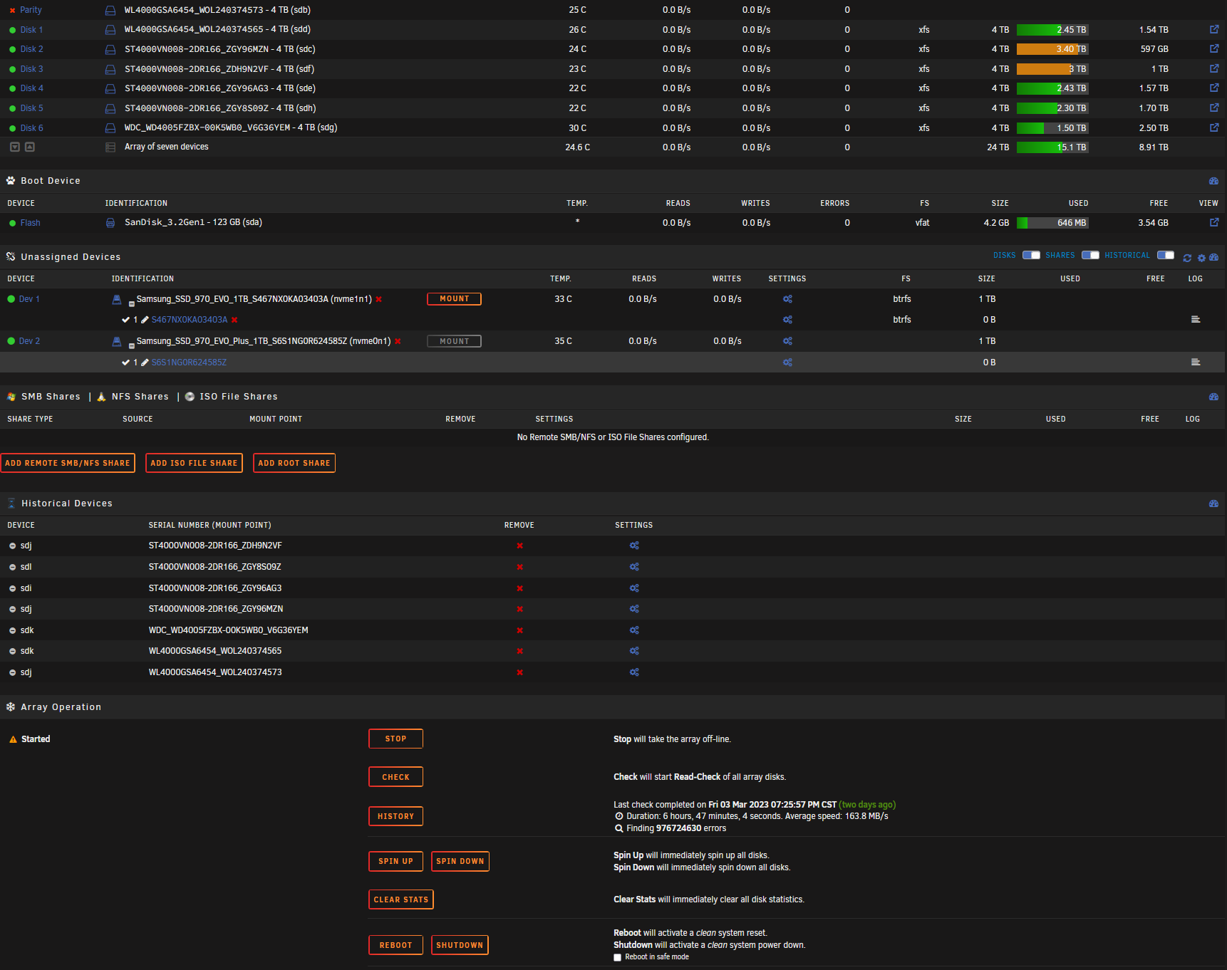

Array started, libvirt deleted (i believe). Here is the most recent diagnostics.
Here is most recent screenshot of Main tab. For when I attempt to fix the array.

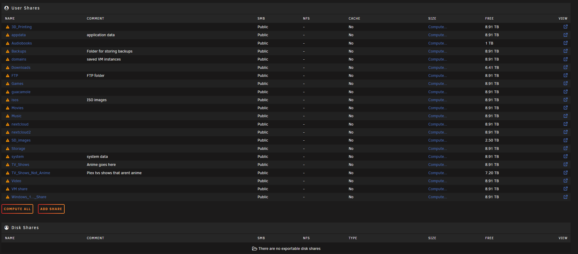

And my normal SMB shares have shown themselves on Disk1 again. No more linux file system.

Everything looks good so far, try re-enabling parity now.
I though the read check that it offered me would fix the disk being disabled. It did not.

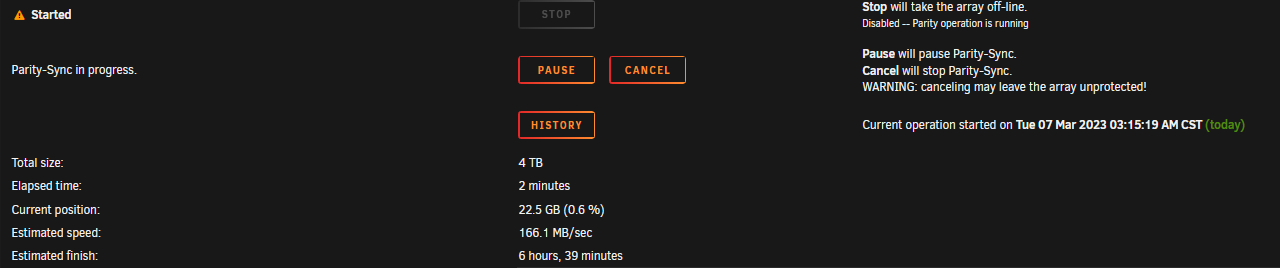

So I performed the start array with out disk and add it back trick. The array is performing a parity sync now. Parity drive is enabled now. I'll see how it goes, last time it did it's parity check but then the drive was disabled again, but that shouldn't happen now with the VM issue removed. I'll past back here with results sometime tomorrow after some sleep.
Yeah, that won't do it, should be OK for now or the disk would become disabled almost immediately.

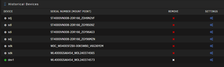

Can I remove these historical disks without further issue?

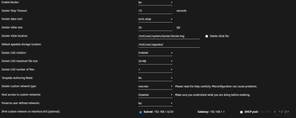

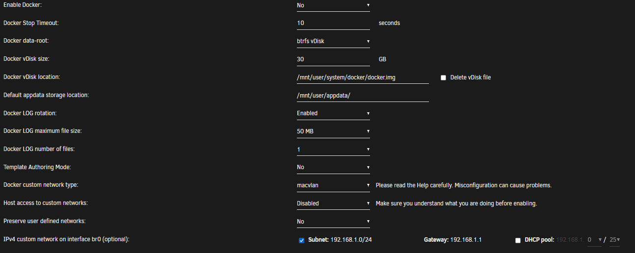

Disk1 is down again. My docker img was corrupted at some point so I went to go fix that. I also had 2 images on the array, docker.img and docker-xfs.img. I deleted both then started the docker service with these settings. Do we know if this has caused Disk1 to go offline. This time it says it's enabled but unmountable: wrong or no file system.
EDIT: I found a previous post referencing xfs_repair. I was able to execute the command and disk1 appears to be back and operational.
Yes.
