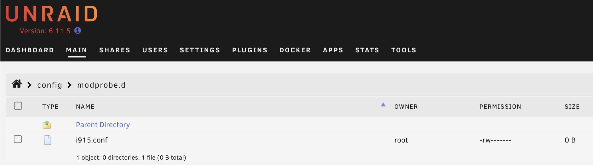

I created the blank i915.conf file using "touch /boot/config/modprobe.d/i915.conf" from terminal, but still nothing shows up in system options or Plex transcoding.

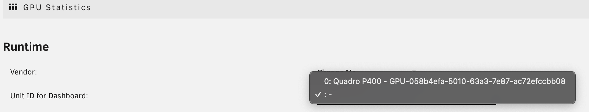

I've made sure my Plex extra parameter is set for Intel, and removed all Nvidia options from the container options as well. Is there something that I'm just missing here? The one thing that worries me is I found in fine print in the manual of this motherboard that it doesn't support integrated graphics, but that was in the "Rear I/O" section of the manual, and on the spec page it lists "Graphics" as "n/a", but it wouldn't make sense that the motherboard actually disables a feature of the CPU I'd think, so I'm sure I'm just being dumb here. I do have the Nvidia Driver, GPU Statistics, and Intel GPU TOP plugins installed. When viewing the different devices on GPU statistics, only the Nvidia shows up.
