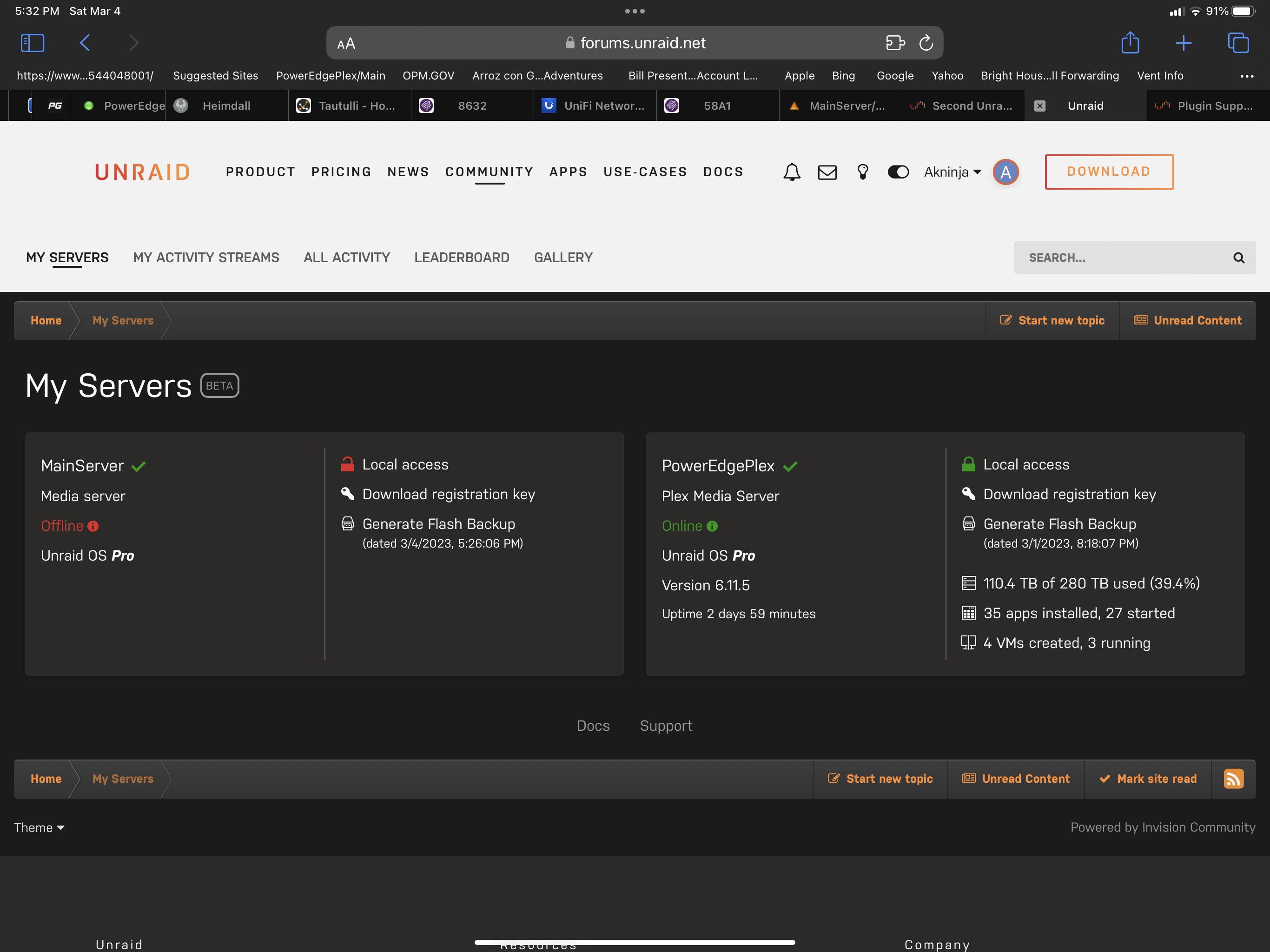

I have setup an additional unraid server.  It shows up under the my servers dashboard, but is red.

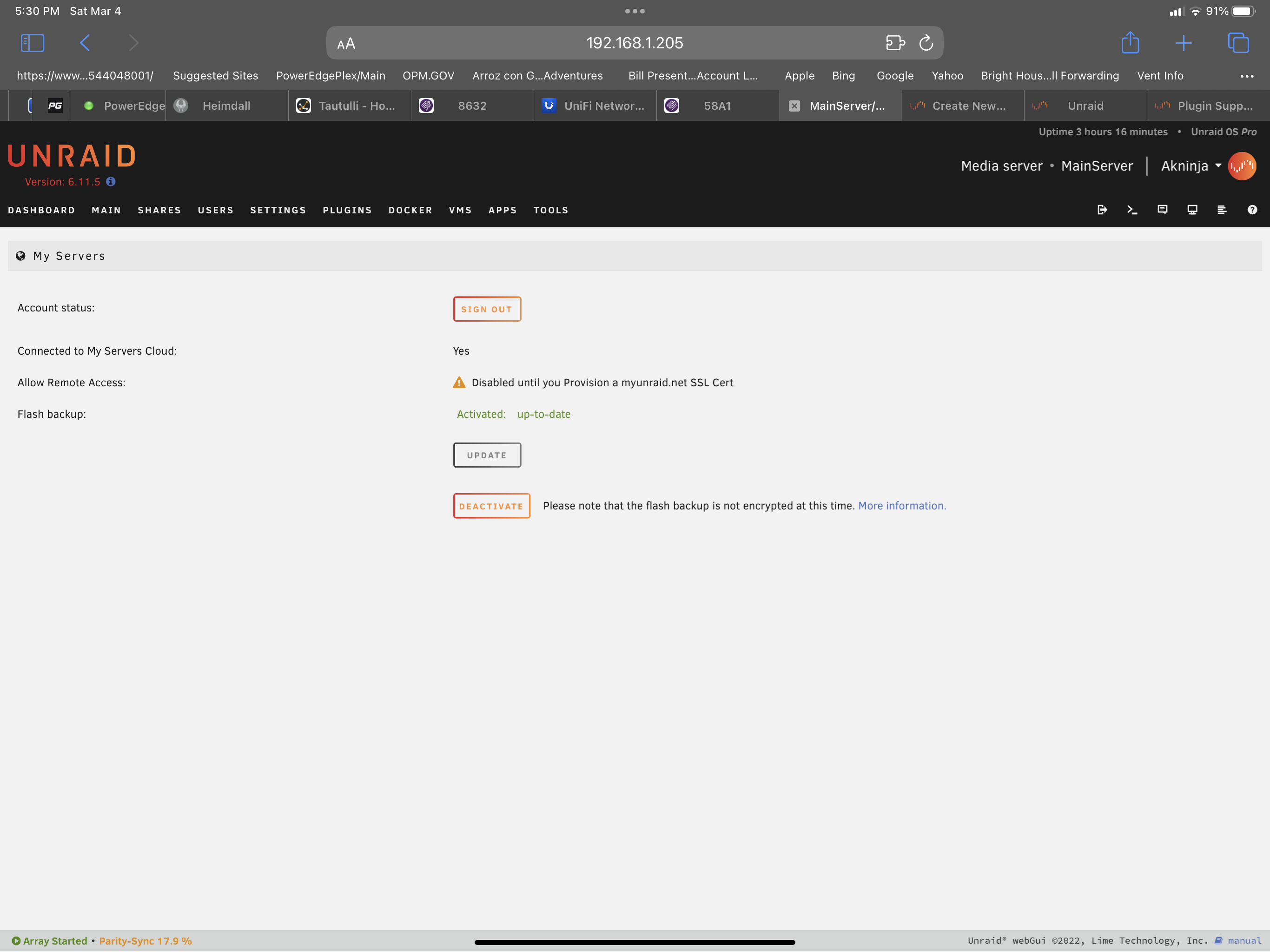

The plugin displays the following.
Disabled until you Provision a myunraid.net SSL Cert
It should be noted that both unraid servers are on the same local network and I can access the original server just fine.
What am I missing?

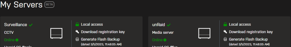

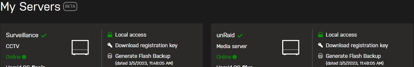

Additional picture

Remote access requires a myunraid.net SSL Cert. Navigate to Settings -> Management Access and press Provision.
